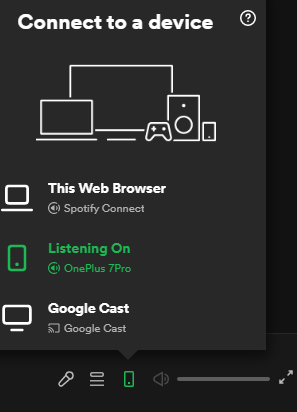

How does Spotify differ to airplay when streaming to the Pi?
MaSh
For Airplay, the stream originates locally on the device that you initiate the stream from i.e. your computer, phone or ipad and is transmitted through your local area network to the Pi.
With Spotify, the phone/ipad/computer only works as a remote control whereas the stream originates in the Pi itself.
MaSh
The mode of operation is totally different. @DB1989 has explained this. Just want to add that the way spotify does the streaming is vastly superior to airplay. The streaming happens directly between the spotify server and the PI playing the music. The spotify client (regardless from where it is run) instructs the application named librespot on raspberry pi, to stream the music directly from the spotify server. librespot is an extremely well written application in C.
In Airplay the first streaming happens between the apple server and the device where you are running apple music app. When you do airplay to raspberry pi, there are totally 3 machines involved. First the apple music server streams it to your apple device. Then from that apple device, another streaming happens to the raspberry pi. It is very prone to stutter. So in reality there are two streams happening simultaneously when using airplay. This is like a relay race. If one end drops the batton, the runner will have to stop. I suspect, that the shairport-sync application on raspberry pi isn't as well written as the spotify librespot. Even without any music playing it is consuming CPU. See the below screenshot. The librespot is happily doing its job with much less resource.
Till date, I have never found spotify (even once) streaming to raspberry pi stutter, even at bitrate of 320 kbps. airplay to raspberry pi however stutters quite often and there is always a lag between when you hit the play button and when the song starts playing.

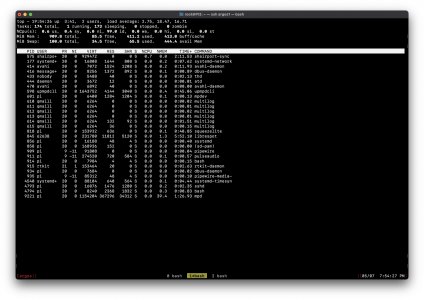

Okay, so moode is in place. However, I have an issue. The connect does not stick for more than 7 seconds in the android phone. For those 7 seconds the Pi shows connected and music plays quite well. However, after 7 seconds device gets disconnected and then the music stops. I do not lose connected when connected to the Moode UI on the browser. Tried rebooting it, rebooting my router, restarting spotify service, etc.
MaSh
MaSh
The android phone as no role to play other than sending command to librespot on the pi to play a song. So if android phone shows disconnected it means that the pi is getting disconnected for some reason.
