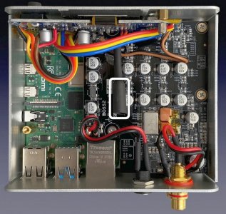

Actually Allo Boss2 is an RPI4. It has 4 usb ports and you can connect any external dac to it and play music. So you are not limited to just using the onboard dac connected to the GPIO ports.

It is either RPI4 2GB or RPI4 4gb. The boss2 is a card that sits on the GPIO pins. There are two versions. Acrylic and aluminium case versions built to accomodate RPI4. The boss2 board can be pulled out easily. also the RPI4 usb ports are accessible.
Features
  • Boss2 Acrylic Includes: Boss2, Acrylic Case with OLED screen and Remote control. Case compatible with RPi4 only.
  • Boss2 Alu includes: Boss2, RPi4, Aluminum Case with OLED screen and Remote control. Case compatible with RPi4 only.
Here is the inside of the allo boss2 case with a RPI4 and the boss2 card connected over it. I own around 5 allo products myself along with all their power supplies. Many a times I connect an external dac to play music from my allo piano 2.1 player which has Kali and Piano 2.1 board over an RPI4 board. In fact I have made my own distribution of linux for allo devices with bits and pieces released as opensource
These allo devices run linux and hence are very flexible in accomodating anything connected to the USB ports. Just connect any DAC and run the command aplay -l, it will show you the dac connected. Run alsamixer and you can control any configuration the external dac has.
Features

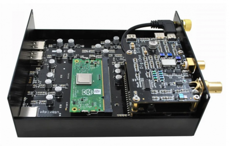

In fact that's how one connects the digione board over the usb signature. The allo usb signature is a bit different from other allo devices. It doesn't actually use a RPI but rather the RPI3 compute board (the green board in the picture below).

One problem with these allo devices are the quality of usb ports. They suck big time. Just few weeks back I repaired my allo revolution dac. It is still under warranty, but the pain of sending it to bangalore and waiting for it, I did it myself. The same issue is there with the USB port on the allo usb signature. Allo boss2 is fine because the USB ports are actuall from RPI4.
Basically there are two issues with allo products
1. Wherever the board requires manual soldering, the jobs is often botched up.
2. The quality of usb ports metal casing is bad. USB male plug that goes in will not fit tight and will often have lose contacts. So I removed the factory fitted usb ports and fitted my own.
