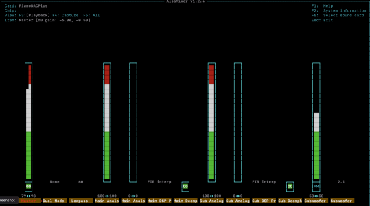

login to the shell and run alsamixer. See if there is a imbalance in the left and right channel. I will post a screenshot after I switch on my allo device.
EDIT: Screenshot posted
This is how the alsamixer screen looks like. Look at the left channel (79) is lesser than the right channel (98). This can be fixed by using the up/down arrow key
