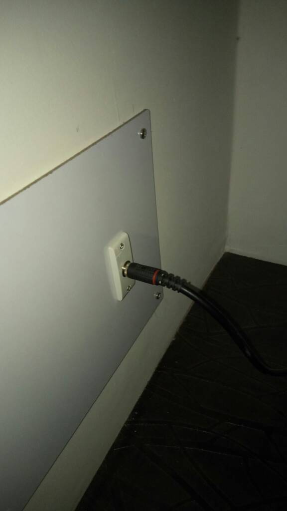

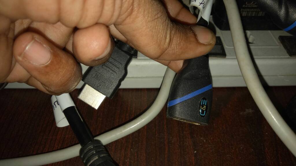

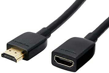

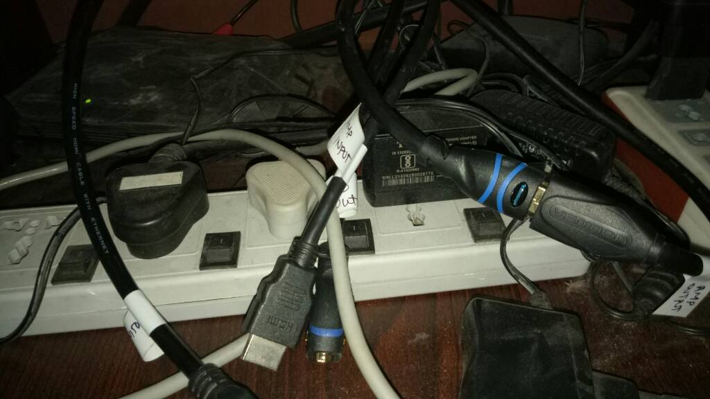

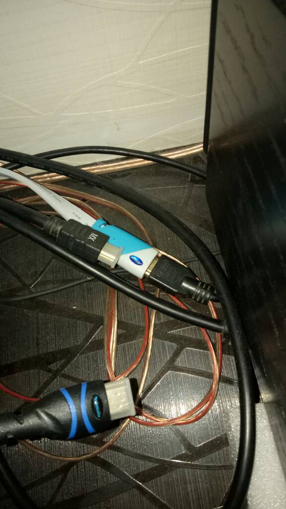

Installed New Earthpit(individual house), bought 5 sets of male female hdmi cables and crimped connector to tatasky LNB connections.
These connections i will be using it whenever it is reqd after which i will remove it easily.This connectors will be useful to access the input and output for AVR/TV/TATASKY/HTPC/ since it is not easy to access at backside of the equipment
Pls find the attached images you will get some idea how we can prevent.Invest on those connectors we will avoid chain of failure and damaging original connector on backside of equipments.

I would strongly recommend to go for hdmi female connectors as a preventive action to everyone.
