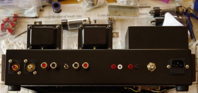

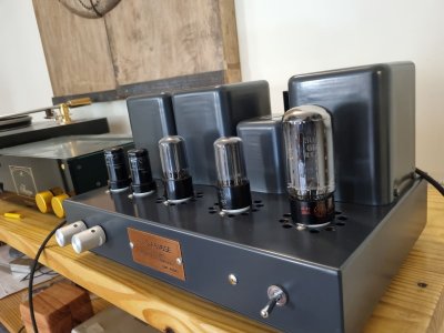

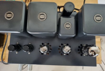

On the rear side:
L to R - RCA input /Speaker out (toggle in-between switches UL and Triode) / Test points for B+ and Cathode V. / Secondary toggle (275 & 300v).
On the top:
Right side - bias switches
Left side - small toggle does Solid-state and Valve rectifier switching

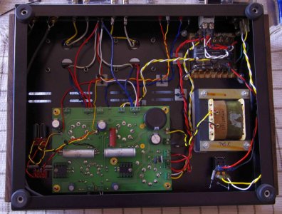

Completed a Tube SSE (Simple single ended). This build has a few things that make it very versatile.
- Switch Sec. V between 275 & 300v (B+ upto 360v)
- UL/Triode Switch
- 4 bias levels to run different tubes
- Switch between tube /solid-state rectifier.
The design is by George Anderson. Check it out here - a very versatile board. I've got a few more builds coming with various voltages ( B+ 460v for 6550) and one with a regulated screen voltage for running sweep tubes.
The transformers are Edcor and the CCS ICs are IXYS10M45s. Everything else is sourced locally. Thanks to Beginner_N (Nishant 🙏) for the chassis.
Its an easy build.

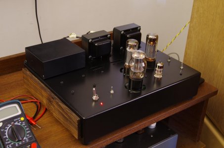

When I fired up the SSE I put a pair of Mullard EL34 XF2. I wanted to be sure everything was running well, but this tube likes higher voltages. Tested on another board with 420v ~ 25w dissipation, it can really rock. But thats another story.
The board in the pic was made for low power, upto 5w (B+ 360v) and the 6V6GT RCA are going in tomorrow.

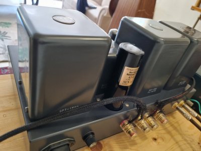

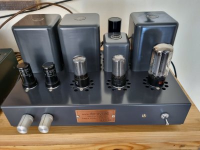

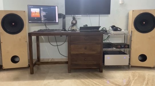

Attaching a few more photos of the Sun Audio 6v6SE. The tamura transformers seem to be key as the circuit under the hood is minimally populated.

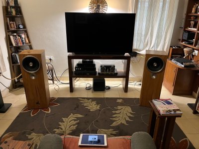

Rocking it with Zu Audio Dirty weekend powered by LFD LE Mk5
Got slam, finesse, sound stage width and even depth, nice transients and decay of notes. Plenty of nuanced lows. Tighter with the LFD than the 300B SET. Source is the Bluesound node 2i and the DAC is MHDT Havana
Life is as good as it gets with Midfi

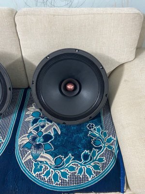

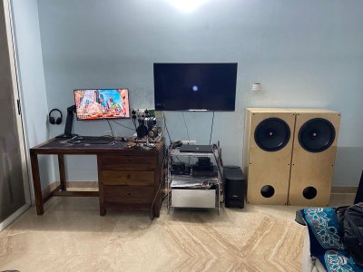

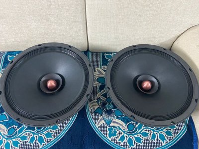

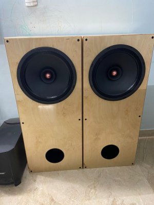

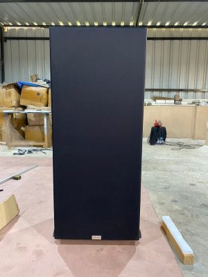

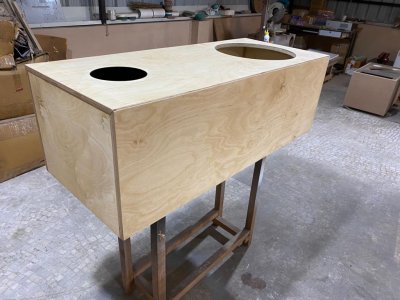

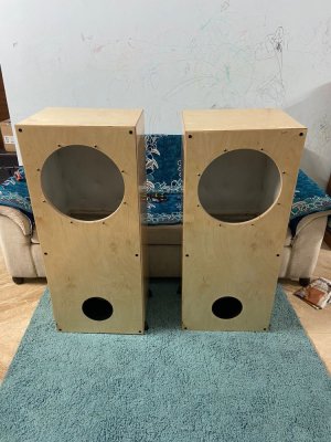

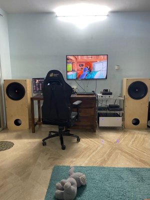

Late post alert! The project started in March 2022 & in June 2022 I finally got these. So the idea of Audio Nirvana drivers came from a fellow audiophile & a good friend @kartikay (Kartikay Mohan Sharma). Coming from Focal Aria 923, I decided that its always better to have easy to drive speakers then the likes of the demanding once, so the final purchase decision was Audio Nirvana 15". @sadik is the obvious genius behind the built (& what a piece of work these finally came out to be). After a hug hiccup in logistics (like the delivery van meeting with an accident & going down the mountain... literally) I finally received the wooden boxes carrying my speakers, a big shout out to Sadik bhai for the amazing built, finishing, patience + that iron clad kinda packing which saved the enclosures.
Coming to the sq, AN15 are quite fast with amazing tonality & sounds glorious, the holography is top notch, be it the width or the depth (the perception of height is yet to be fully tested) they produce without sacrificing the pin-point accurate imaging & the resolution, they way these disappear is some different uncanny experience. The full range sub bass is different & when called off, they do produce shattering sub bass with absolute control & sometimes I wonder if I am re-discovering the tracks which I have heard earlier. They are still maturing with time & so is my setup, lots of changes to follow. With no crossover & a sensitivity of 99db+, the ANs are easy to drive & I feel they could do something superb with a quality power source like toooobs or low power class A amps.
That's a wip till the next post ;).

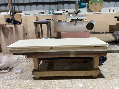

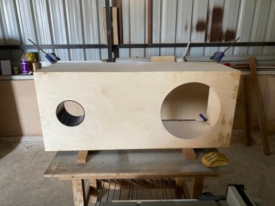

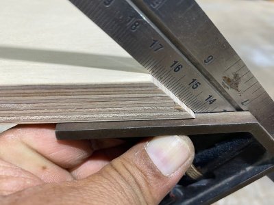

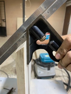

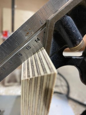

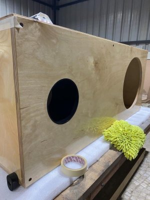

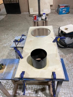

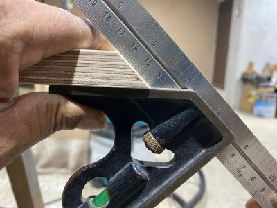

Someone is really impressed with his 45-degree bevel cuts!
Nice! I wasn't even aware we got birch ply here. They look nice, naked.
Yeah..... its birch ply only... if you notice the built in process pics. The current finishing is very much naked, just a nice layer of protection & polishing. Staining birch is a pain & requires importing some stuff which is not even available here.

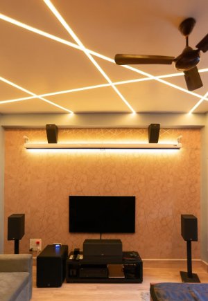

I was living in an apartment since dec 2004 (please check Openplan living room thread, 3rd in google ranking. lol), but decided to move to a house due to space constraints. Now I've more space to play around with my hobbies.
How i achieved this
I'll update the kit list & finished pics here, but keep the work in progress in my DIY threads here and here. There are some detailed info related to following (gathered from several threads and members):-
Living room
Bedroom 1
Bedroom 2
Bedroom 3
Office (where my wife lives :)) room
Kitchen
Roku M1000
AE Aego M 2.1 Speakers
Wiring Hub
Other electric & energy saving bits
Nothing great, taken the route of X10 due to budget constraints. I use appliance module for switching Energy efficient downlights controlled via harmony 685 remote, Subwoofers, 12v suppy for PJ, hidden EE / LED lighting controlled via RF remote.

Apple Music > LG V40 > Marantz PM 8006 > Elac Debut b6.2
Considering you have spent so much on this equipment, you will do justice to those loudspeakers by placing them on proper speaker stands. You will likely gain some improvement in sound quality too. You don't want the speakers tipping over.
I agree. Three or four cement blocks on either side may also be an affordable solution ?
Firstly, my apologies to the high empath forum members who were triggered by my speakers precarious position.
However, this is more of a temp setup. The current room I am holed in is small and waiting for my master bedroom wall repairs to get done.
Aiming to have a more elaborate aesthetic setup there. :)
