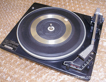

Found it!! More than a year back when I searched the Internet high and low I could not locate the TT that I grew up with (I had no clue about the model number). Somebody mentioned a model number and that whipped my curiosity as in all my searches on Garrard I recalled never chancing upon it. (G00gle baba did not help G0bble baba :mad:) So I searched out the images on the net and viola!!
The SP25. Thats the one I grew up listening to with a shure cartridge.
How is this TT rated in the Garrard stable and compared to others of its time? It sounded way better than the Clinical digital sound for sure.
