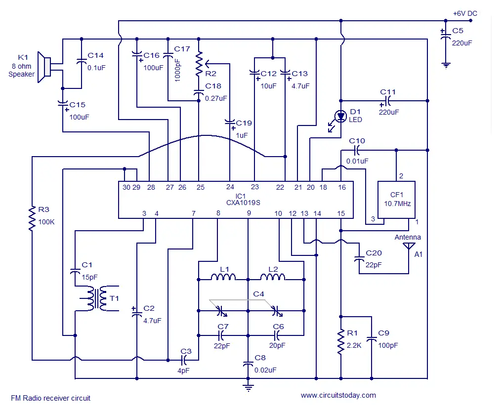

Dear all, wify has been asking for a FM radio for quite some time. Her requirement was not something exotic but functional and portable. I had looked around for an old FM 2-in-one or radio (even put an advert in our wanted section) but could not find anything. Hence decided to make one myself using a Sony CXA1619BS IC, a PCB and components that were lying around, salvaged from old radio PCBs, not forgetting stuff which was to be thrown away.
The circuit is similar to this one:

The inspiration of this project came from here:
http://www.foxdelta.com/nina/fmradio.html
