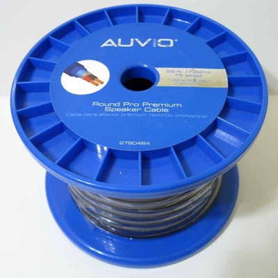

I use the Radio Shack Auvio 12 awg. Very good stuff.
From where did you source it?
