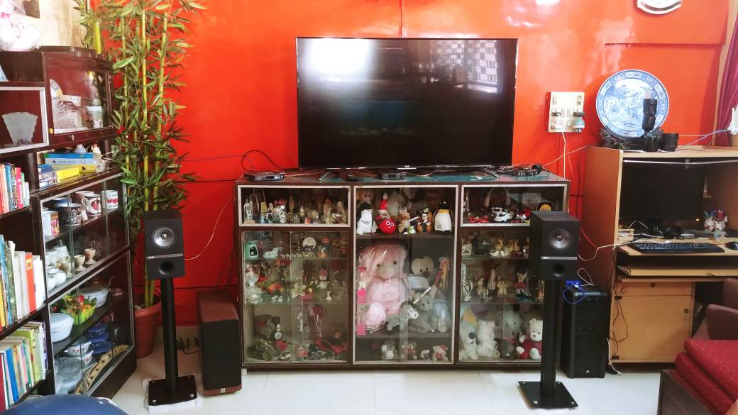

Took some time but finally got my setup completed yesterday with a pair of Sound Foundations Nexus stands. Picked up the Kef Q100 and a Q Acoustics 2070i sub for a superb price on olx. Was also lucky not to have been charged any customs on the Q5 Pro.
I noticed however that the sub out on the Q5 Pro seems to be loose - read this at a couple of places online too and facing the same issue - there's a constant loud humming from the sub and makes it unusable. Worked well a couple of times but if the wire moved even slightly, the humming became unbearable so I've connected the sub using the high level inputs and regular speaker wire.

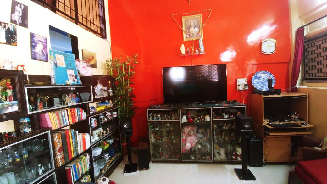

The Kefs have a surprising amount of bass for their size specially at moderate to loud volumes. The sub comes in handy at lower volumes and if I need even more bass punch. Now just need to finalise placement as mom says the speakers are blocking the showcase and wants them placed back closer to the wall. Any suggestions on placement?
Sent from my LG-H870DS using Tapatalk
try always using the sub dont play kefs loud without the sub there have been instances of woofer blowing up especially with the q series. as with the placement lil toe in is ideal with these try to experiment with moving the speakers and in the end dont fuss about it too much and enjoy the music.
