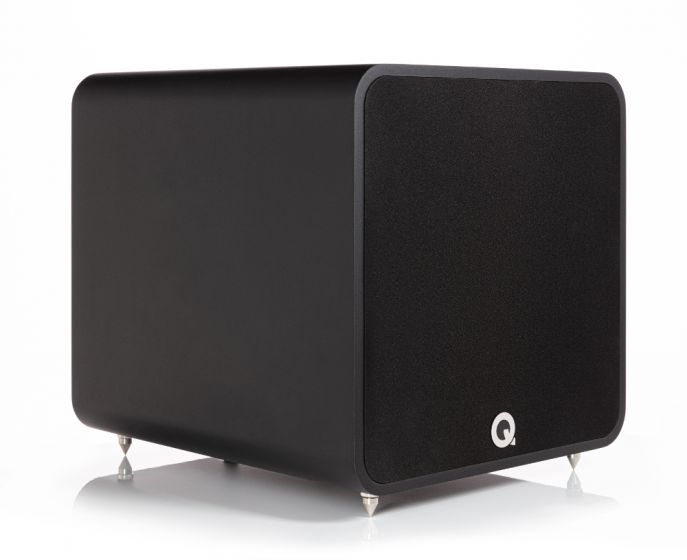

While your budget is decent, it makes more sense to go with reasonably priced equipment and gradually build up.
AVR :
My experience is all with Denon and has always been positive.
I would suggest the Denon X3000 series as minimum for a room of that size. Current model is Denon X3700H.
If you can fit in budget, get the 4000 series.
Prices are currently very high. Shop around , and get multiple quotes, before deciding.
Speakers :
Try to audition many speakers.
Go for a brand whose sound signature you like, and prices fit in your budget.
Brands I would suggest checking out :
- Q Acoustic
- Dali
- Polk R series
All of these will allow you to start with 2 floor standers and a sub, and then later add centre, surrounds etc.
For example, you cna start with :
- Q Acoustic 3050i floor standers, and
- Q Acoustic QB12 sub woofer
These should be able to fill your space with sound.
Hope that helps.
And as I said, prices are high right now. Shop around for deals.
