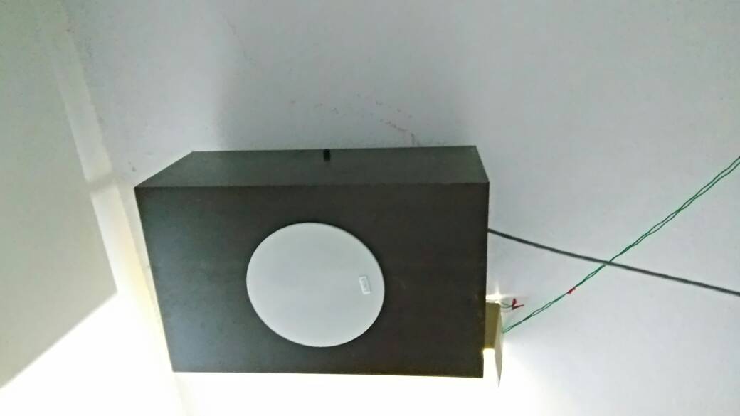

To suspend speaker's from concrete ceiling for Dolby Atmos / Dts X..
Got the custom iron brackets done for Rs 120.. Painted them too..
Tried fitting them on enclosure with necessary mounts..
The big screw that you find on the brackets, will go in to the ceiling.. itz abt 2 inches depth..Almost flush mounted to ceiling..
The custom made brackets are holding the enclosure with M8 Allen key screws on the sides of the enclosure..
Speaker & wire connector to be fixed on the enclosure and will be mounted to ceiling..Hope to complete, by this weekend..

Yet to be mounted..But, it should hold them firmly.. Will update when done..
Was the ceiling able to hold the boxes with the said 2inch(D) screw??..
With that box plus the speakers are definitely going to stress out those 2" screws on the ceiling. Just to be on the safer side, how about using a wooden plank, just like how you've used it for your screen hinges.
A 5"-6" plank fixed to the celing with a couple of 3"or 4" screws. And the speaker is mounted on this plank. This should be much more sturdier than fixing straight into the ceiling.
Thanks for the inputs..Will check feasibility..
I have used these 2inch bolt (M10 size) to mount ceiling fans where there wasn't provision to mount on ceiling..Think, a ceiling fan must be approx 4 kgs weight.. In that regard, the enclosure must be 8 Kgs (incl of speakers). which i fairly believe should hold the static weight..

How far are they from the rear wall? From this angle they look a bit too close to the wall.
Approx 10 inch from rear wall..

Are those Taga Harmony Platinum TCI 100R? Where did you buy them and how much does they cost?
Yes.. They are TCI 100R inceiling speakers.. Offline .. 18.5K INR/pair

Anyways, from the DIY expereince, any in-ceiling speaker with an enclosure should work, provided you make the tilt provision to adjust to your listening position..
