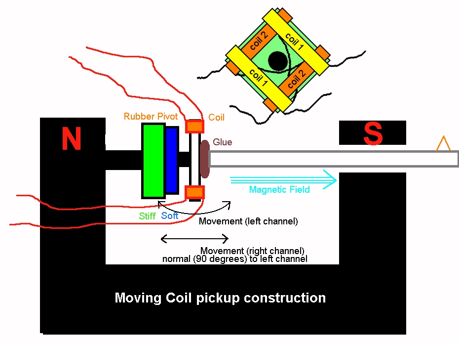

Done some reading and things are rather clear. First lets see how a moving coil cartridge operates.
Moving coil cartridges
The first cartridges with Hi-Fi specifications were developed in the mid-forties and were of the moving coil design. In general, moving coil cartridges are more expensive than magnetic cartridges and they do not, therefore, enjoy the same popularity. However, the most demanding Hi-Fi enthusiasts remain loyal to the moving coil design because of its great linearity and lower distortion.
Compared with a moving magnet cartridge, the reverse principle is applied in the moving coil cartridge. Here, a powerful fixed magnet is used and the coils are mounted on the cantilever itself. When the coils move in the field of the magnet, they cut the flux lines of the magnet and voltages are generated in the coils. (Fig. 6)
(Fig. 6.) Moving Coil cartridge principle. The coils on the cantilever move in a powerful magnetic field, and voltages are generated by induction.
Once again, with a moving coil cartridge it is important that the moving parts be as light as possible. Therefore, there are only relatively few windings on the coils, and the output voltage from a moving coil is generally so low that it cannot feed a conventional amplifier without special steps being taken.
