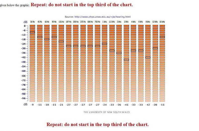

The test is not 'wrong'. It is not accurate, because the equipment used to administer the test is not calibrated to any standard at all. And the person administering the test is you. Since you have to quantify 'equal', it is still very subjective.
You *have* to understand the test in the context of how it is administered, and the text on the page. It is indicative, as even the text says - but even then the 30Hz sensitivity is close to 24dB lower than 1.5KHz tone, and you've got a huge midrange peak in your hearing at 3KHz and 8KHz, or the resonance of your headphones. We'll never really know till you have a calibrated test done. And it does start dropping off - at 16KHz you are -30dB down from the 3Khz tones.
Oh, and you'll notice it is from 30Hz to 16KHz. That is more or less the outer limit of human hearing - though some people have supernatural hearing and can go all the way to 22KHz.

But my original point of reference was ability to hear above 14KHz.
In fact I did the test with other headpones.
CX300
SE310
sony mdr-xd300
And the earlier image was related to Creative PC Speakers.
( settting were all Flat(no dsp/eq ) and in Audio creation mode for Creative X-fi, Creative x-Fi titaniumn( repeated the test on another pc also)
All sounded in 3 different responses for each freq.
This was like more of a headphones test than my ear's test:D.
Also to note is, only speakers and Shures were able to give the tone at 16khz - and was a bit irritating and what ever the plotting is for loudness with reference to 1khz is "so so", dificult to compare.
the other headphones responded with a hiss similar to running a Blank Audio tape at a high volume - so was it the actual tone or the atifacts to deliver 16kHz tone - i am not sure.
Personally sony sounded in a balanced way ( but the sound quality is Filmsy when compared to Shures - including bass)
