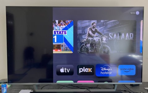

Yesterday all of a sudden while watching my 75Q1 TV's display went dark. I could notice that the backlight was still on but there was no picture. The TV was bought in May 2021 so it is out of warranty (it only had 2 year panel warranty)
The technitian came today and said there seems to be a short in the panel. He spent an hour trying to fix it. He got about half the screen working but confirmed that one of the panel components is short and he wouldn't be able to fix it himself. He said either you get the entire panel changed or he has a friend that has a specialized machine which can potentially repair this. Approximately 20-25K for repair if its successful.
There is no damage to the actual LCD panel but the guy named some internal component where there is a short. I didn't really understand the part he was referring to. Lastly he said these CSOT panels are hard to repair, especially the 75" onces.
I erally don't see the value in getting the panel replaced since it'll probably cost 50K+. Does anyone has any experience with getting this kind of an issue fixed?

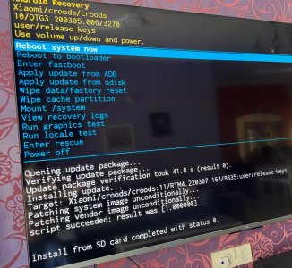

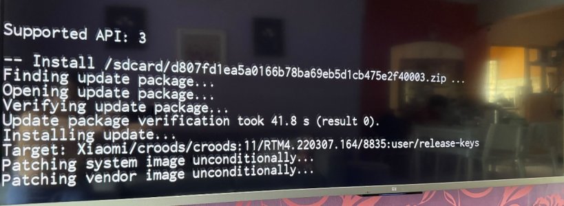

issues I faced to enter the recovery mode.
- My remote is Bluetooth (I think most people will be in same boat, thats the stock remote control)
- So entering into recovery mode, before the OS boots up was not possibe by remote key press method
I could get into recovery mode using android tools installed on a PC & then connecting to TV (the Reddit post above has the process for this, follow the same)
I could enter the recovery mode
- but can't navigate the menu - same issue as remote cant connect without bluetooth and OS booting.
- unfortunately the TV doesnt have any buttons on it, except power ON/OFF
I connected a USB keyboard to the 1st USB port on the top, rebooted and re-entered the recovery mode
*no one has USB keyboards these days, I got one from my office to avoid buying one
- Keyboard was detected and able to navigate the menu
- however connecting the thumb drive with software image zip file into the 2nd USB drive doesnt work
so u are in catch 22 situation now. u cant connect USB keyboard and Thumb-drive to same port. so we need a USB hug.
got a USB hub from amazon - portronics make for INR 250, delivered in 10mins by Amazon NOW :-)
with this I could upgrade the software.
attached are the pics, 1 & 2 are for software upgrade.

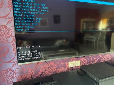

once upgraded and rebooted, I entered the recovery mode again, to delete user data and factory reset (pic 3). to remove any old baggage
with this the TV has improved and less sluggish.
