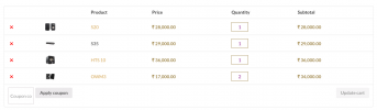

In my apartment I dont have space to put a floor standing speakers. Thus, I will need to use bookshelf. Is the following a reasonable configuration for 5.1.2 (Polk speakers)?
Centre - S35
FL/FR - S20
Sub - HTS 10
SL/SR - OWM3
Ceiling ATMOS - OWM3
Profx prices
These are decent speakers and subs, but the pricing is not.
Check out better bookshelves if you can with other dealers too, don't trust on the listed prices, bargain and some try to price match too.
Agree, pricing is probably off. I will need to negotiate with them. The speaker selections are primarily from this video.
