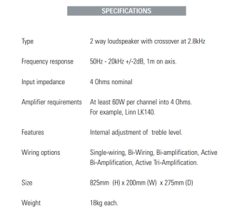

Dr Bass, i just don’t think the 300 tube amp is cut out for a modern Tannoy.
Our point of disagreement is that.
It’s not whether a Tannoy is good or bad or a 300 tube amp is good or bad
I would take the neutrality of a ATC over a modern Tannoy. And when i say modern, it’s what’s available today. Yours are probably over two decades old.
You know i was considering a vintage, original GRF. But even there you know i was recommended a 100 watt CH Precison amp.
The only Tannoy that really works with a 10 watt amp is the Cornetta. We both know that too :)

Rajiv, i was referring to the original Cornetta in the mini GRF box. Not the Japanese one. Soneone Dr Bass and I know well was mentioning that the original Cornetta with the 10 in Red driver was the only Tannoy model that could he comfortably driven with a 10 watt amp
Prem, Tannoy Reds and earlier models have lighter cones and are more efficient than Golds and later. 10 watts is ample power to drive them.
Golds work well with 10 watts but 20/30 watt EL34 amps make them really come alive.

If that is the model, it boasts a sensitivity of 95db which is quite high.

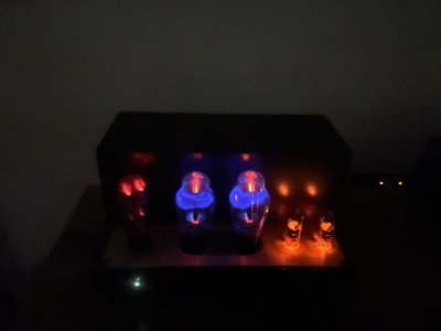

Attached below WE 300bs in action tonight on a Shindo Cortese 😊
