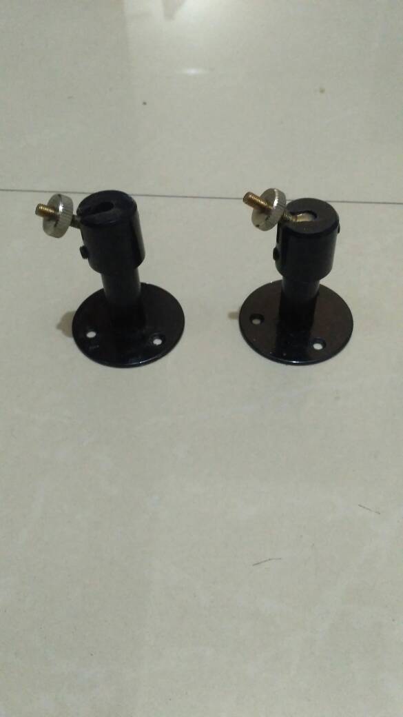

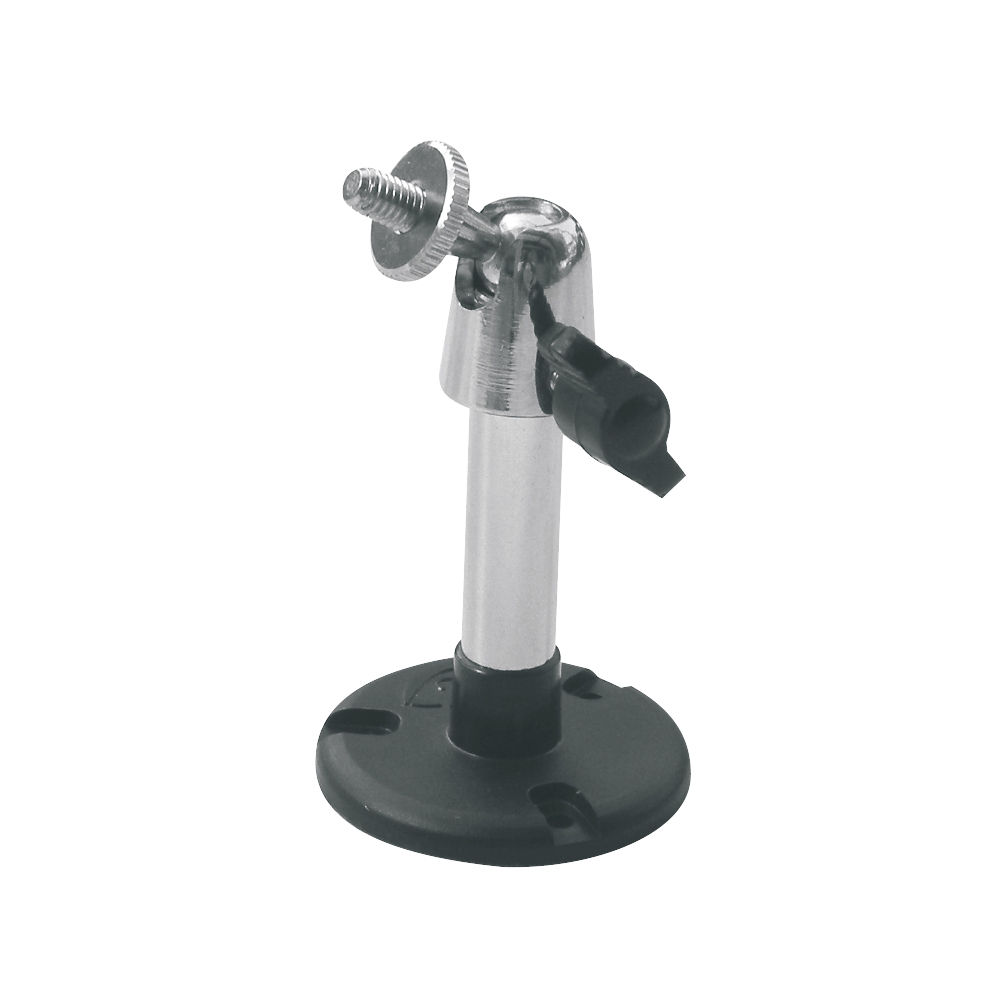

An ceiling mount like this under 500 Rs should be able to hold your yamaha satellite speaker.. (should weight less than 1 Kg)..
search ebay.in for speaker (or) camera mount, you will get plenty of options..

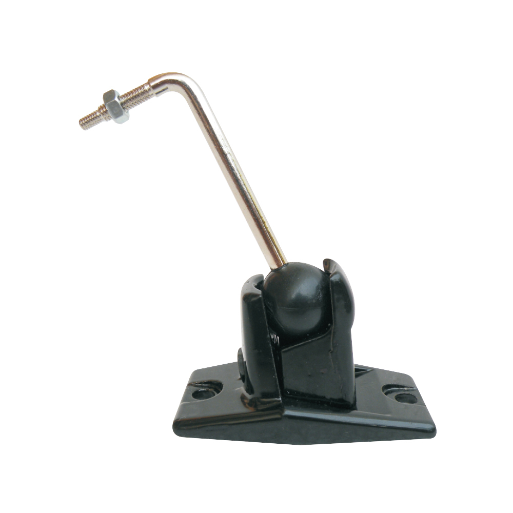

You can surely give it a try like I did. Nevertheless I ended up using additional speakers (Normal Bookshelf Speakers) for Dolby Atmos firing modules and kept the Yamaha Speakers as a separate set up. In case you looking for suitable mounts for 5mm threaded Yamaha speakers, no mount can match this for angled positions. I bought it at Amazon.in for some 1k.
