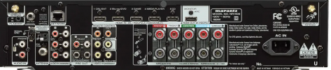

Read this entire discussion and I am still a little confused. Wondering what would work for me.... I have a marantz NR 1509 which has pre-outs. I current have a 4.2 setup ( two subs and still to get the centre channel but it can wait ) Can I add something like a xtz-edge a2 300 ( which is just a power amp ) to drive my two front speakers and also have the subs to come into play for stereo music. Any help will be appreciated!

Yes you can add any 2 ch power amp to power your front left and front right speakers via the NR1509 and also power your subwoofers at the same time (NR1509 has Front L/R preouts which are different from your subwoofer pre outs). If you intend to power the Elac Debut B6.2 then yes they would benefit from a power amp as they are not very easy to drive. A cheap way out if usage is primarily for movies would be a crown xls 1002/1502 power amplifier , they should give you a good amount of improvement and will cost you only about 20/22k in total.

Am quite happy with the movie setup...was looking to up the stereo experience. Wanted something that would seamlessly work be it surround sound for movies or music. So in the setup you recommend, I connect the front L/R pre-out from the AVR to the power amp which would mean the front and left would be driven by the power amp while the surround speaker and the center channel ( will add in future) will be driven by the NR1509 and this will work seamlessly for both movies and music?

Yes it work seamlessly in the manner you described. But from an improvement perspective I am not sure how much better would the XTZ A2 be over the Crown XLS series , there are mixed reviews online about the Emotiva BASX/XPA vs the Crown amplifier. If you are ok with spending about 80k on a PA (the price of the XTZ seems to be 75k) do have a look at IndiQ Saptak , there is a group buy ongoing for the same and they are much better than the Crown/Emotiva XPA series (had demoed the same partially)

Just to be clear, the two subwoofers will be connected to the AVR right? And they will still work when using setup for stereo music?

Yup, they will function during stereo listening as well. The pre-outs for subwoofer are different from that present for the Fronts. If you see below image under preouts there are 4 rca ports - "Bottom 2 for sub 1 & 2" , "top 2 for fronts (red for right front and white for left fronts).
When you get the PA , there will be 2 RCA ports on the same and you can just connect the preouts from your AVR to the Power amp , adjust power amp gain/volume and run audyssey. Then you are good to go.

Thank you so much! Much appreciated! Giving the Crown XLS 2002 a serious look!
