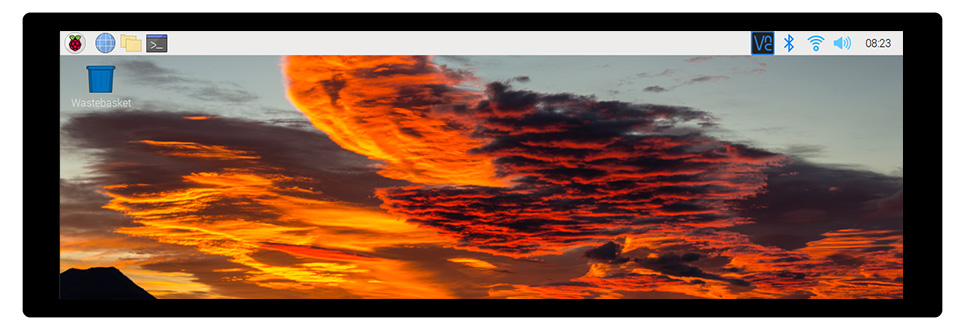

Some bad news. The official site from DSI supports very few kernel versions as seen in this page. So if you install using the instructions from the LCD manufacturer (someone from China), you will be limited to that kernel version. But there is a way to skip using the manufacturer provided driver. See this link https://www.circuitbasics.com/setup-lcd-touchscreen-raspberry-pi/.
In contrast a lcd screen for RPI with HDMI input doesn't require any such installation, but I think it will cover few of the GPIO ports and create problem for adding another card which requires access to the GPIO pins (but maybe i'm wrong, The mounting most likely will be on bottom leaving the access free for the GPIO header).

My guess is that this particular screen will give lot of headaches if the OP goes for installing 3rd party software over and above the Raspbian OS (like volumio, moode, dietpi, etc). See this issue spoken about on the volumio page
Regarding the 7.9inch DSI LCD as far as I can see there is currently no driver fitting the kernel version (5.10.92) Volumio 3.324 uses available from Waveshare.

- A screen :) A screen better than the CXN V2 - basically larger :) I have the 7.9 Waveshare DSI - but happy to buy an HDMI if possible.
