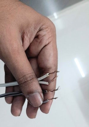

First thing, can I used this existing wire at home, There is so much quantity of this available at home.
If its not going to make a HUGE difference, I don't want to spend much on wires.
Will using thinner wires like this cause any short circuit or anything ?? Otherwise I would just use these.
The print on wire reads : "fybros by kundancab 23/.0060 twin parallel core flat - 1100V nc"
PS: got the whole thing including active sub for 20k. sound feels amazing to me. (used for 5-6 yrs)
attached a pic of the wires

Maybe just purchase some 1.5 sqmm electrical wires from a nearby shop. Measure the approximate length you need. A single coil of 90mtrs will cost you around 1.6k, but you'll probably only need around a quarter of it for all speakers.

That's what I do before inserting them into proper banana / spade connectors. Soldering the ends will prevent the strands from breaking and hence keep the restance as low as possible. And then there are few audiophiles brainwashed by exotic cable manufacturers who say putting solder at the ends is blasphemy. I have tried both and found no difference. Those wires you posted in the original post are thin. For higher wattage you need more current and hence thicker wires. In the audio industry people use the American Wire Gauge as the standard for specifying the thickness. My recommendation would be to get OFC speaker wires from Amazon. OFC stands for oxygen free copper. Oxygen free means that the copper will not get oxidized and the resistance will remain constant as years pass by. The wires you have shown already show signs of oxidation. The colour has become dark brown instead of the reddish brown copper colour. You can easily get amazon basics and MX. There are others too. The Front L and R require the max power. The Centre speaker too should be treated like the Fronts. 12 AWG gauge should be minimum for the fronts and the centre. The surround speakers don't require that much power and you can use 14AWG. For 14 AWG 50ft costs just Rs 699.

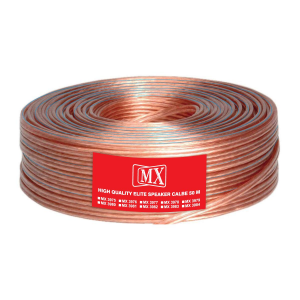

In general the OFC speaker cables look like this. They have a transparent sheath which shows the reddish brown colour of the copper inside and hence any oxidation of copper will be clearly visible.

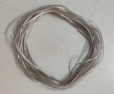

Basically this is a 23 AWG gauge cable (quite thin). Each individual strand is 52AWG (very very thin, but understandable). I would stay away from this cable. From the amazon link you posted, the colour of the cable in the product description looks like copper, but in the review photos posted by buyers, it looks like copper mixed with aluminium, imparting a silvery colour (photo posted below from the amazon review link). This is definitely not pure copper
