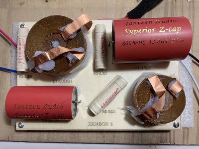

If you want to use good quality components you need to make a new PCB for the crossover.
I upgraded my Dali Zensor 3 and the board was 20x15 cm.
I used good quality Mundorf and Jantzen parts. The sound quality is significantly better.
Now I'm going to build an Oberon 7 from scratch. Cabinets and a crossover. Now I'm going to build an Oberon 7 from scratch.

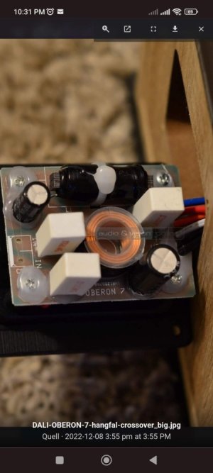

But unfortunately I don't have the original PCB with the components.
Could you take pictures of the crossover PCB with visible elements, please?
I will post my pcb project here.
