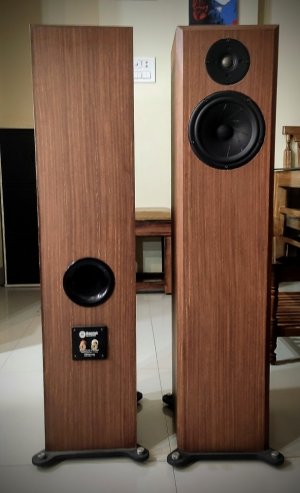

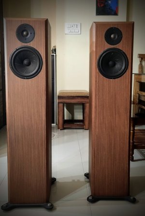

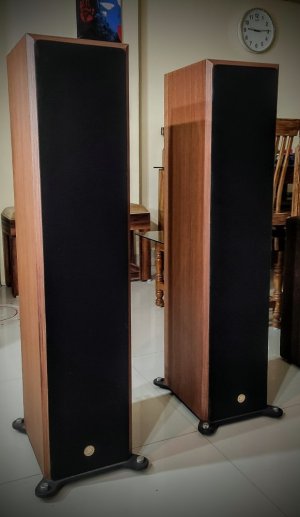

I had the pleasure of upgrading my audio setup with a pair of 2-way tower speakers made by Mr. Suman Jana of Kolkata, and I must say, I am absolutely blown away by their performance. These speakers boast a remarkable combination of features that create an unparalleled listening experience, leaving me in awe every time I turn them on. I have been using them for 3 months now.​
The highlight of these tower speakers lies in their Scanspeak drivers, which have been meticulously selected to ensure top-notch sound quality. The attention to detail in choosing these drivers is evident in the speakers' ability to reproduce sound with remarkable precision and accuracy. The midrange is velvety smooth, and the highs are crystal clear without any harshness.The bass extension of the 7 inch scanspeak woofer will in some cases make me think as if a sub is existing in my audio rig. It's as if I'm experiencing my favorite music and movies in a whole new light.
The 2nd order crossover design is a testament to the speaker's engineering excellence. The simplicity of the crossover design doesn't compromise on performance; instead, it enhances the speakers' coherence and ensures seamless integration between the drivers. The result is an incredibly natural sound signature that lets the music breathe and flourish without any artificial coloration. Thanks to the Jantzen components used in the crossover.
What impresses me the most about these tower speakers is their neutral and lively sound. They strike the perfect balance, delivering a performance that is engaging and exciting without being overly forward. I find myself getting lost in the music, as every instrument and vocal comes through with clarity and realism. Whether it's a gentle acoustic melody or a thunderous orchestral arrangement, these speakers handle it all with finesse.
The build quality of these speakers is equally exceptional. The 25 mm HDF enclosure, along with the heavily braced design, ensures that there are no unwanted resonances to interfere with the sound reproduction. The difference in sound quality and overall experience was so profound that I didn't hesitate to sell the 7 month old Dali Oberon 7 at a considerable loss. It's a decision I don't regret for a moment, as these new speakers have redefined my audio expectations.
In conclusion, if you're an audiophile seeking a transcendent listening experience, I wholeheartedly recommend these 2-way Rediscovery tower speakers .They offer a neutral, coherent, and lively sound that will leave you captivated with every note. With their impeccable construction and unmatched performance, these speakers are worth every penny. And being a DIY product from an extremely passionate and one of the very best in speaker designing, what Mr. Suman Jana is offering is mostly acheivable in commercial brands at thrice the cost of the Rediscoveries.
Mr. Suaman Jana designs and build speakers under brand name Saptak Acoustics. Currently he has three products - Raga: 2 way reference bookshelf speakers, Rediscovery: 2 way reference tower speakers and RaginiBe: 3 way reference tower speakers.

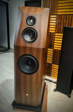

I have had the pleasure of listening extensively to RaginiBe (three way) Reference speakers made by Mr Jana, at my friend's place. In comparision to my Harbeth P3esr bookshelves , the floorstanding RaginiBe sound is bigger and bolder, more transparent, quieter (in background), airier , although marginally grainier and slightly thinner sounding ,rooted in the midrange towards the top, whereas the harbeths are rooted in the midrange towards the lower side.The bass is room dependant and requires careful placement but is tilted more towards quality than quantity and some listeners in larger spaces may want a slightly heavier sound . In conjunction with a high quality source and amply sized , high quality amplification capable of driving low impedances, the speakers can be part of a real high end system.
