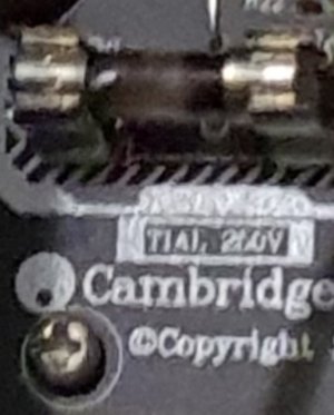

Thanks manohar,
Fuse is written as T1AL 250V as shown in picture
1A Glass fuse will do the job I hope
Is it important T and L ratings of fuse, its not easy to get the exact T1AL fuse

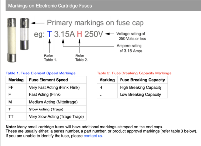

The fuse is totally blackened. I suggest put a 40w filament bulb in series. It is not difficult. You can call me if you require clarification. This is a slow acting 1 A fuse. Slow acting means it will allow current above the 1A rating when you switch on but not after. L means that the fuse will blow off with current just a little bit over 1A. Pull out the fuse and there are two metal caps on each end of the glass cylinder. Take a magnifying glass and you will see the Ampere rating engraved on one of the metal caps. It should be 1A.
