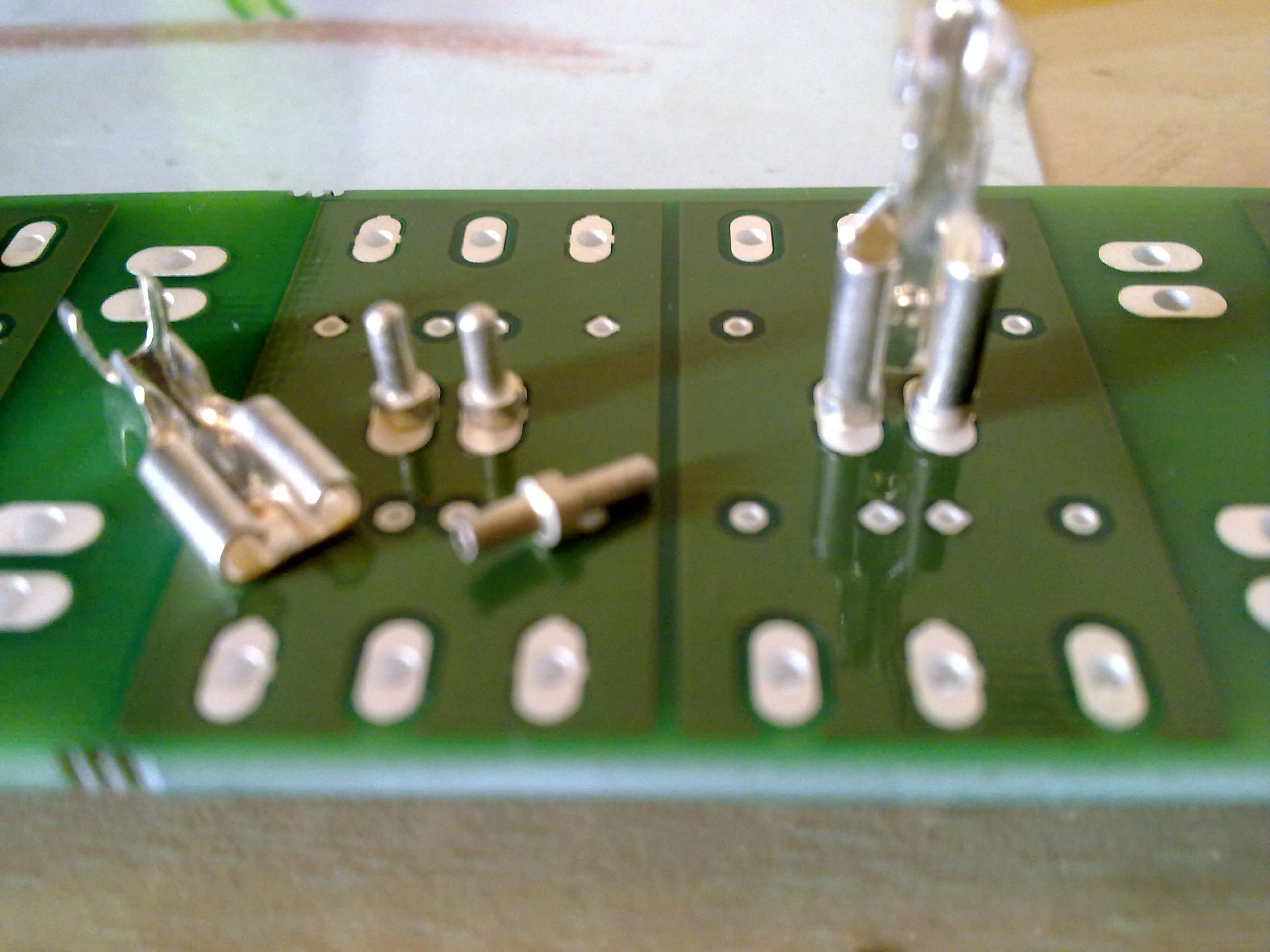

The size we wanted is 4.8mm on PCB. Unfortunately in local market I could not locate one except 6.3mm ones.
Edit: I think there is some goof up here. Distance between the centres of holes is exactly 4mm which show 5mm in the software design. Why this scaling happened? Still that 4.8mm will do but with little bending.

Sachin, these tabs are 4.8mm wide and not the leads.

More information is required if we use it from PCB-PCB, what about wire headers? If we get those pins then also we are fine.
[Sorry for bad picture quality, there was little time for me to focus and get the snap from mobile phone camera.]
This is our problem now -
And this seems to be solution for me.
Is this okay?
Initially I thought this will be cheap but its not that cheap, comes ~6Rs for each (2 pins+1 clip).

I think bending a leg of that PCB connector should work since difference is only .2mm
