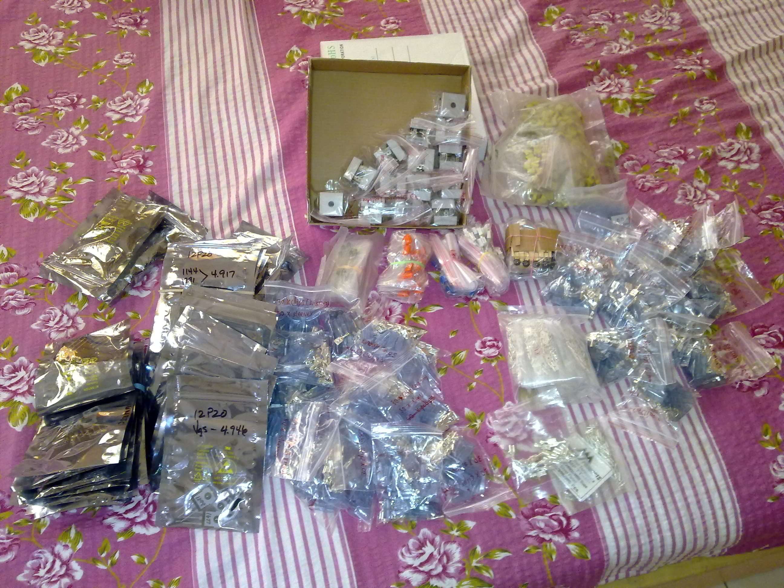

Okay..so wify is out and I can scatter the bounty on bed. :D
All parts are separated and packed to make individual sets. Only waiting for 11 sets of diodes from US. Once they are in, I am done.
MOSFETs, clips, sleeves, presets, NTCs, small switching noise eliminating caps and ground isolators bridges.
