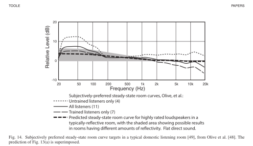

Past 6 months i have been living with my previous OB speaker and my new ones which was built 3 months ago. The first order crossover for this speaker was completed around 2 weeks ago. I both listened and measured these speakers couple of times to understand what is going on with them.
When i measured the speaker as per standard norm, they sound reasonably flat from 40Hz till 20KHz with excellent step and other measurements. But when i listen to this speaker if will always find them little thin in subbass and somewhat brighter highs. So past 10 days i tried to fine tune them by listening without much regard to how they measure. I later measured them as to how the settings measured. I noticed that i prefer an increased bass in the subbass region below 100Hz by around +3db. My head prefers a flat response from around 100Hz till around 7KHz and from there on a slowly rolling off response from 7KHz till 20KHz so that the 20KHZ is around -3db to -6dB down. This measurement allows me extended hours of listening pleasure without fatigue and to my liking.

The phenomenon at work regarding preferred sound balancing sounds familiar
However the above is just a small part of the overall picture about why one prefers such a sound balance.
Part of it all comes down to personal preferences.
Another part of it comes down to speaker design and acoustical sound power matching across the full spectrum based on different radiator types used in the speaker. Specifically in your case with at least low & mid-frequency (constant directivity) dipole radiation, it is theoretically possible that the total acoustic power radiated in the woofer range is about 3dB less than the total acoustic power radiated in the mids. See here for a deeper discussion about the matter:
Then comes the constant directivity horn at the top (I assume there is no dipole radiation in that range with this speaker). With a constant directivity horn, most people prefer a down-tilted sound balance in-room.
The situation might have been different if that region too had dipole radiation.
