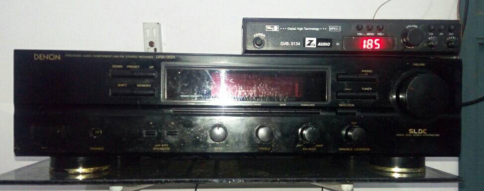

Dear friends,
After trying umpteen attempts to get good FM reception at our native place I gave up and went for the softer option.
Installed a DD DTH STB and we are smiling. Seriously, all it took was 1500, some cabling and two hours. The endless experiments I did with tuners and antennas seems so ridiculous now. The reception is crystal clear, obviously and the best thing is that around 10-12 channels seem to be useful. I mean FM channels only. All AIR channels are there and what more can anyone ask.
There's is a HD version also which can be plugged into a DAC for better processing. It's around 700 more but I was not interested since father likes the simplest possible setup.
Probably I may miss my tuners refined signature sound but father will not even bother. He says it reminds of World Space which we had subscribed as long as they were in India. Even now the BPL receiver sits on the terrace.
Anyone struggling to get FM reception can seriously consider this. TV is not needed for changing channels also. Just jot down your favourite FM channel nos and you are set. Best thing is that you can access all AIR channels and Vividbarathi etc without for life free of cost. Should have tried it earlier. Pl let me know if you have any queries. I will be happy to respond.
Cheers
Sent thru mobile
Some pics of the STB and my newly acquired Denon Receiver which is driving the speakers now.
Sent thru mobile
