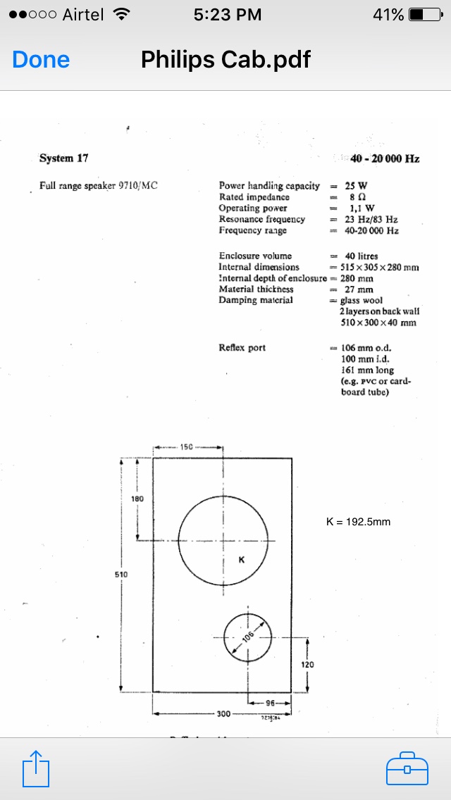

Can someone provide the baffle cut out diameter for the "Boston Acoustics - HQ48414P - 8" Hi-Q Fullrange Driver - 8 Ohms" ?
Thanks
Thanks
