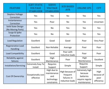

UPS is nothing but a combination of rectifier & inverter. i have mentioned the drawbacks of ups for av setup in previous reply. attaching a comparison sheet for you. I had similar apprehensions for months before deciding to invest in static stabilizer about which i am extremely pleased.
By the way what is your primary area of concern? is it voltage swings or frequent power failures?
