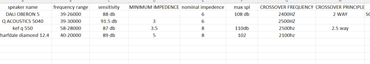

hi i have shortlisted these 4 tower speakers. now wharfdale 12.4 has best minimum impedence of 5ohm but has less max spl of 102 only also crossover frequency is only 21000hz if compared to others. which model to choose and as usual i dont want harsh trbel to my ears

Specs really tell you next to nothing - best thing is to audition them.
The Denon x4800H is a good amp so the impedance isn’t really relevant. The cross over frequency also tells you nothing about how much the ‘dip’ is. THX reference level is 85dB at listening position, so 102dB is more than enough ( loudness doubles every 3 dB, but also the max SPL spec doesn’t say at what distance ).
Please hear them out as they’re all good options.

yes, exactly. 4800h can drive these speakers well. Try to audition these speakers as you mentioned.
