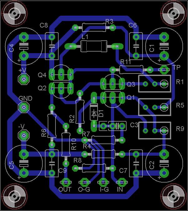

For the PCB, Jean Paul makes a lot of sense with what he proposes in Post #257
I just replicated layout from post #266
Its good except grounding and power capacitor placement. For low signal buffer i would use ground plain or better segregation.
Let me try.
Tried hands on this layout. It is nicely done by DIYA member 'Project16'. :clapping:
Its aleady nice grounding layout post #266.
I just replicated it in software with some addition of 0.1uF shunt capacitors across PS filters. It has optional D1 (1N4148) and PS ground is separated with Analog ground.
Trimmer pad size doubled. :D
And it is okay for single sided PCB. That guy is genius.
Edit:
Forgot to mention PCB size. Its 50.80mm x 57.15mm.
Om, really nice.
Should you move R8 up and R4 down? Those 3
resistors will line up nicely, and some traces can be optimized.

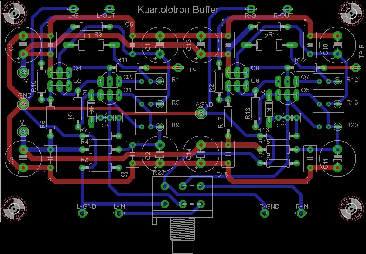

Wishlist (culled from Jean Paul):
Stereo board
PS on same board (detachable)
Connectors for a potentiometer
Stereo board
