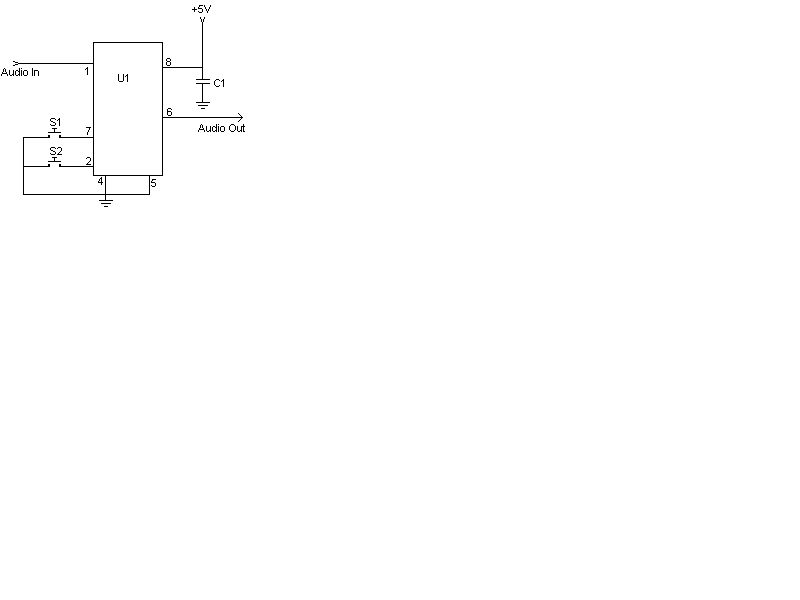

What about digital ic volume control ? Schematics look simple. Can we replace regular vol. pot with this ? Are there any advantages over regular vol. pot. ? Just needs DS1669 IC and .1uf capacitor and 5 V battery. Can we replace the 5v battery and take it from the transformer itself.
What about digital ic volume control ? Schematics look simple. Can we replace regular vol. pot with this ? Are there any advantages over regular vol. pot. ? [/IMG]
The question is - how linear is the analog signal path in these digital volume controls? I'm guessing that it will be ok, but not linear enough compared to the rest of the signal path of the MyRef.
