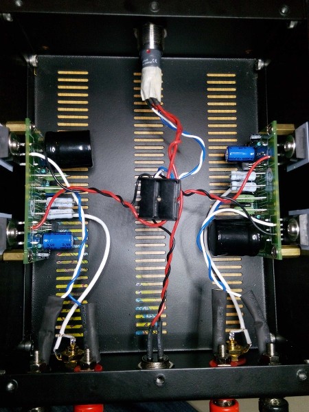

Few build Pics:
Heatsink grease applied on Mosfets and soldered them on board as my board is single sided.
Ready to be mounted on heatsinks
Sachin

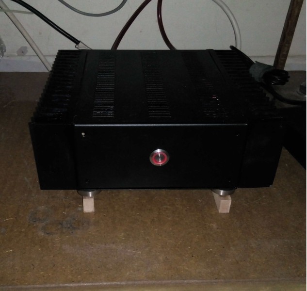

Here is my ACA
Thanks Sachin for the components and Raghu for the plug and play cabinet having excellent quality and finish.
Why I built it: I wanted to listen to a single ended class A amp
How long did it take to build: Five hours
How does it sound:In one word (looking at the size) - Unbelievable.
Had read very positive reviews about this amp, so though about building it for my second setup.
I am listening to Pass F5T since around a year, and my power amp expectations bar is quite high, however I would say that this amp has its own signature which is different from F5T, the bass goes deep and is very tuneful, resolution is excellent and over all it generates a very soothing effect.
It very comfortably drives my speakers which are 90db sensitive, If I use LOMC cartridge I need to turn the vol beyond 2 o'clock, for all other sources and carts it drives very comfortably at 12 o'clock, I will need to buy a SUT for my 103, it is long pending.
My (own personal) verdict : Looking at the size, cost, and DIY efforts involved, the way this little one performs, makes this as one of my most rewarding build, and I believe it has the potential to beat the amps costing many times more, in performance.
Thanks for looking.
~Happy Listening~
-sann'
Few days back I completed my Amp Camp Amp build #2 for my son. and this is too amazing like first one. This time I added those stainless steel feet, in fact mirror mounting screws with SS covers. Looking great.
I don't think it is less powered (Average RMS 5W/ch only). Its too loud with my GR research speakers (86dB). One small class A SET Power Amp, definite keeper.
Thanks to nraghunadh(Raghu) for nice chassis, sachu888(Sachin) for kit and svaze (Swapnil) for all wiring and misc helps. Raghu has already provided PCB mounting standoffs, Screws, RCA, Banana Plugs, illuminated switch and 2-pin SS power socket in completed chassis. Great!
