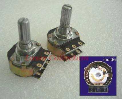

Few more upgrades I am thinking to add a remote volume control with ALPS RK27(10K) (Blue-Velvet) Currently I am using a 10K Stepped Potentiometer with SMD resistance inside, I am afraid if I will degrade the SQ by switching from Stepped to ALPS, Could someone shed some light on this.

Have anyone compared the step potentiometer against ALPS RK27 (blue velvet), I'm using a DACT step potentiometer as shown in the below pic and URL, could someone advise if I replace this step potentiometer with blue will it be an upgrade or a downgrade?

I haven't tried either the DACT stepped attenuator or the ALPS RK27, but either of them should be fine. I'm guessing that the DACT may have a slight edge in resolution. In principle, it should be possible to modify the DACT using better SMD resistors, including Susumu RG and/or Beyschlag MMU0102 micro-MELFs, but it probably involves a lot of painstaking work to unsolder and solder the SMDs. It may also be difficult to find replacement SMDs of the same values.

Hi step potentiometer will bet better than ALPS RK27 but stepped need to be with good quality switch .The above mentioned one is very good what I have got good feedback from many users.Also somebody told me it produces a click sound sometimes not sure about it.
If you looking for Alps there is one old model which is excellent that is ALPS black beauty they stopped production will be costly to find out but worth
+1 to hifiramr.
I used to use ALPS Blue Velvet RK27 on Kuart buffer. Changing it to the 23-step stepped attenuator definitely improved sonics. Recommended!
