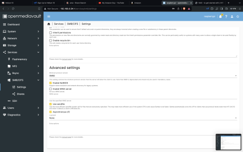

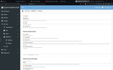

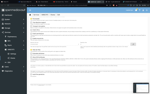

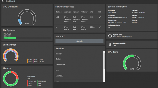

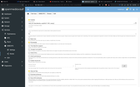

My requirement is only sharing Audio files between my devices (Streamer, TV, Laptop) and manage the audio files centrally. Setup the the old Raspberry Pi 2 with Open Media Vault with mini DLNA plugin. Followed the below YouTube video for the setup instructions. All went smooth except the setup took more time considering the old version of Pi.
