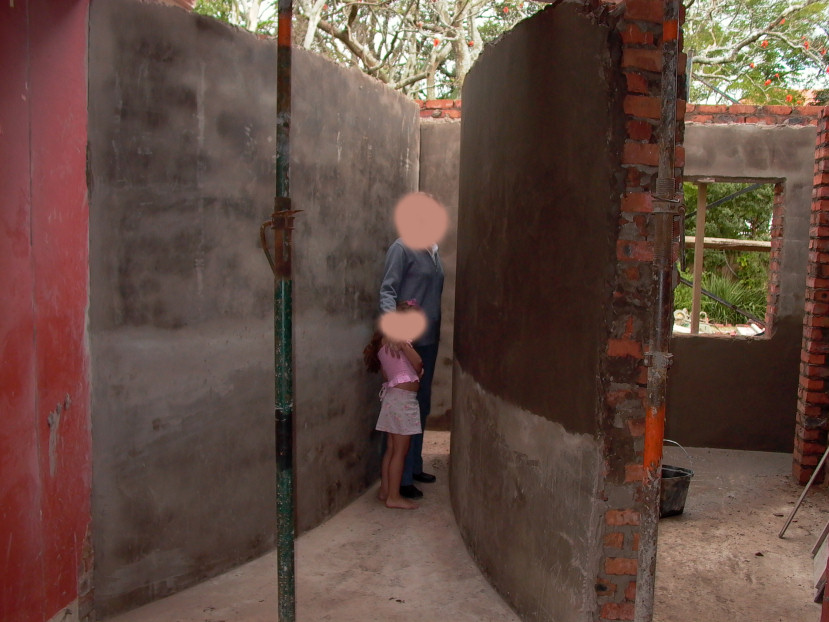

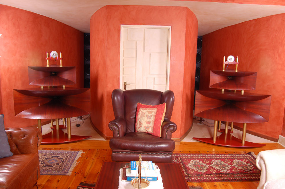

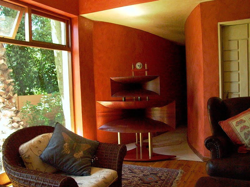

As regards construction, someday maybe I shall construct like this
place these
to make the whole setup look like this
- LIVING IN THE HORN.
How horny can one get, huh?
Cheerio

Where can i find more details about this build?
@cmsajith
I found this on retro vintage modern hi-fi.
Sadly, No further details on the build here.
http://itishifi.blogspot.no/2010/05/live-in-horn.html
There are designs for wooden horns on the net galore. As far as the subwoofer walls are concerned, you'll have to choose 4-5 infinite-baffle-compatible subwoofer drivers (for each of the subwoofer channels on each side) and then run some simulation software to get at the measurements of the floor/ceiling (both slanting downwards/upwards respectively) and side walls. Not too tough for the better read, IMO.
I recommend at least 15", preferably 18" P-audio subwoofer drivers from Thailand for the bass. Great quality at the price. Reliable sources indicate that our Ahuja guys outsource a whole lot of stuff from there.
As regards wooden horns, I have a few Japanese pdf plans that I will be most happy to share.
Hope this helps.
