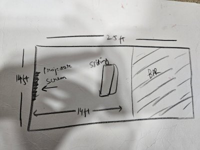

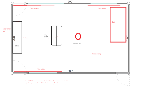

Attached rough layout for reference.

Yes. But the remaining area is on the back side of the sitting area. Please check the screen placement in the pic for reference.The sitting area is 12-13 ft and the rest 12 ft will be utilised for bar.

Hello,
That's a great room size for an HT.
First things first, wire the room for as many speakers as possible. at least 7.4.4.
Also, I may be wrong, but your projector mount distance vis-a-vis the screen size you are aiming for may be too close.
There are online calculators for throw distances. Some even allow you to just choose your projector model and will compute the requisite throw distance.
Check one of them once before finalising the mounting points.

1. Go for the following in the first spend: Wiring + Projector + AVR + LCR + 1 sub
2. Add surrounds and 4 nos Atmos speakers + second sub if you still feel the need. (Note: Getting the best out of dual subs will require some time and effort, though. Please go through the experiences of those with duals/multi-subs)
3. Power for front stage if you feel the AVR is lacking once all channels are driven.
Wishing you all the best

Actually it's already wired for a 5.1.2 system. I can maybe try to make 5.2.4 in future but don't want to spend too much on it.
Dis the projector calculation and max is 12 inch screen size with maximum zoom.
I want the HT experience only for 14ft.If i am planning to sit 10 ft from the screen,do i need to have floor standing and 2nd sub? Please check the attached layout for better understanding
Yes, unfortunately, the whole room counts, when it comes to soundwaves and bass pressurisation.
This is oversimplification, but the basic idea is that sound waves will travel till they hit a wall (behind, on the sides, and even the wall where your screen will be) and come back to you, from behind and other sides.
You need to correct it with either DSP/treatment.
DSP (which a good AVR will have some decent level of) is the easiest. Treatment addresses your room and will be more permanent.
Most of us make do with AVR room correction. The most hardcore amongst us do treat pur rooms to militant levels.
So, yes, your whole room counts. This is why most people have been telling you to go dual subs. Because at some point a room as big as yours is difficult to fill with bass.
(Unless you are going to have a hard separation between the bar area and the HT area, like a faux wall or something. Then the measurements change. This is important)
And please don't get disheartened with all this. Start low, start slow, and you will enjoy this journey.
As for floor standers, yes, I would highly recommend FS for your room for the front stage. With minimum 8" woofers. Or 8-12" QSCs or AIAs or something similar.
