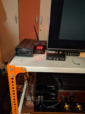

First thing is do get a digital multimeter which sell for as low as Rs 200. What I have done is put a good quality voltmeter in my music room like this. I get 220 v after stabilization. You can see my allo nirvana and allo shanti in the image. Both are connected to the same stablizer.

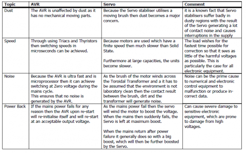

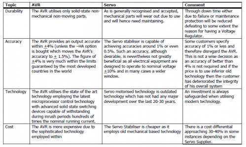

Pros and Cons of AVR (Automatic Voltage Regulator aka Solid state stabilizer aka static stabilizers) vs Servo
Static stabilizers have a minimum correction time of 20-30 milliseconds and have a very high correction speed of 360-500V/s. The servo stabilizers have the correction time of 50 milliseconds to 5 seconds with a voltage correction speed of 100V/s. So, static stabilizers allow instantaneous voltage stabilization. It is plain simple physics. It takes lot of force to move a stationary object. So if the voltage suddenly increases, it takes time for the motor to move and for the motor to move the armature with the carbon brush. Servo is good for heavy industries where you require high power high current. For very high power, it is difficult to get solid state stablizers providing that high output
