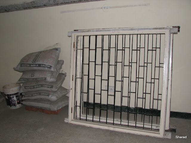

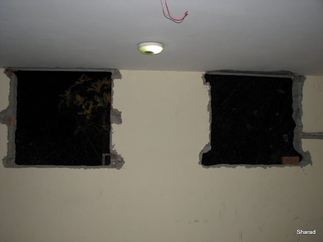

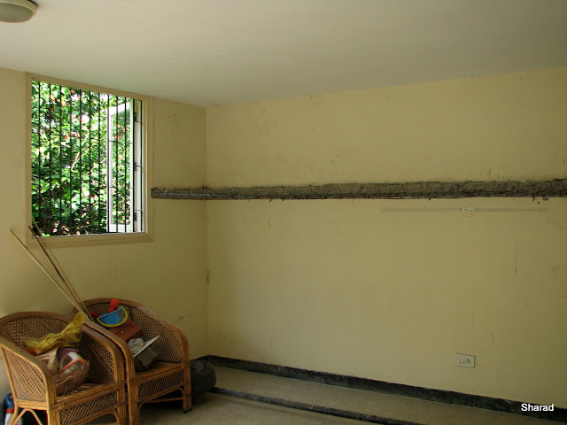

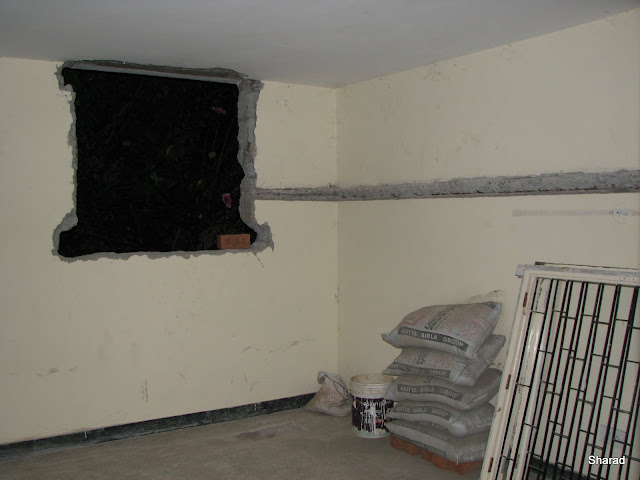

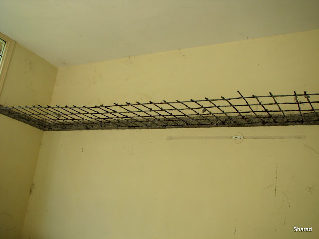

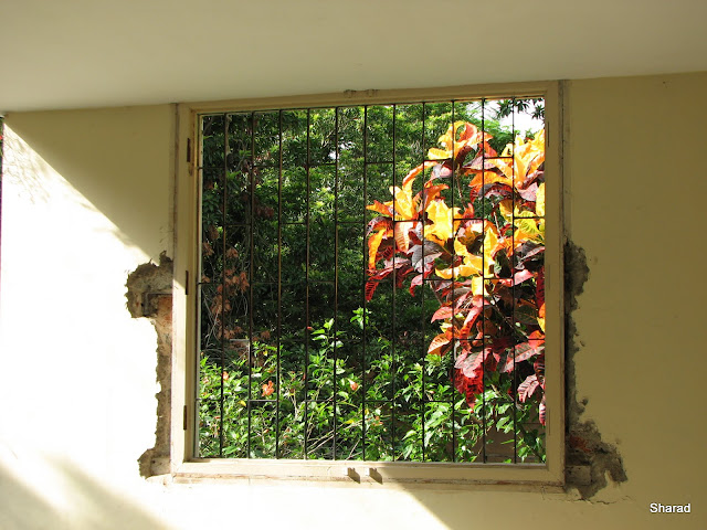

Some updates:
As you might have guessed, I am converting my garage to a home theater and vacating the old HT room for the family.
Here are some pictures:
The loft gone; the steel still remains
A window going...
Both of them
Gone!
Here they are!
The loft goes completely
There was a steel rod on the floor as a parking bumper, that too is gone
More to come...
Thanks,
Sharad

What an amazing coincidence , I am also converting my garage which has a loft and windows. The problem seems to be that the wall next to the loft seems to be load bearing so it may not be possible to take down the loft (so the engineers say). Please PM and let me know if I can visit your place to check how you are proceeding in the initial stages with the civil work, to get some ideas. I visited Santosh and learnt a lot
Manish
