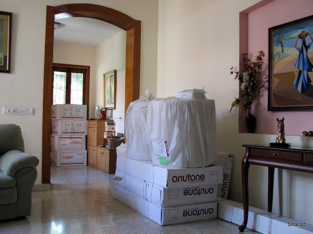

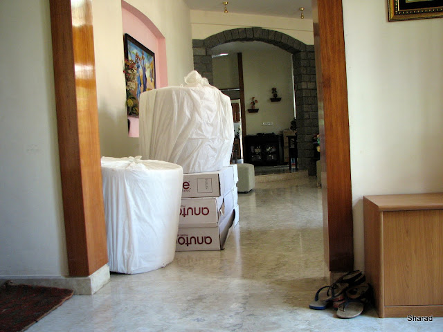

The delivery from Anutone arrived last week. I had visited their godown and demo area earlier, which was quite impressive. They have a lot of interesting products. So now that they have redone the ceiling to my satisfaction, I was ready for the full order, and I am happy with the stuff till now.

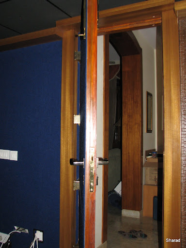

Even I ended up changing the hinges and lock to something more heavyweight as the door thickness had more than doubled after all the additional layers.
Railway couch hinges and Dorset latch/lock for thicker doors:
The Dynamic HomeTheatre Door
Well even i have used dynamic hinges then the usual ones due to heavy weight of the door, if such hinges are not used for sure sooner then later the door will give way laced with in-direct play, the lock which you have used is the one even i have used. I have put rubber sea lings on door corners because of the sunlight and other issues.
