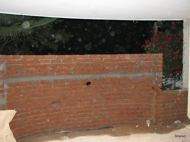

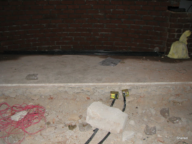

Some updates...
Picture 1 below
Old windows sealed.
Conduits for (left to right):
- A second rear subwoofer
- AC voltage stabilizer (in/out near the floor), switch at mid level and socket near the roof
- Left surround speaker

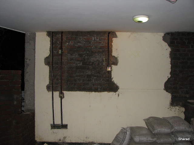

Picture 2 below
The floor goes down for the front seating (11'6" from the front wall)

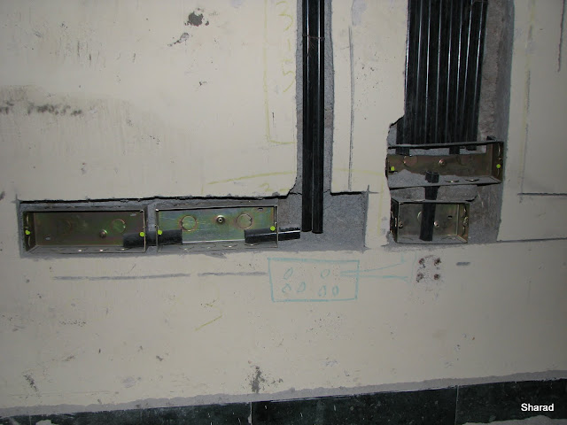

Picture 3 below
Curved rear wall coming up (17'6" at max point)

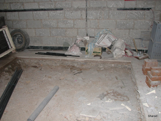

Picture 4 below
Conduits for installing tactile transducers (Buttkicker stuff) on the chairs. Includes a power outlet. These are located on the step just behind the front seat.

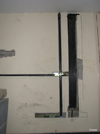

Picture 5 below
Wall behind the equipment rack.
- Power sockets (3Nos 5Amp, 3Nos 15Amp), one going into the false roof for the projector
- A lot of them going into the false roof for speakers etc.

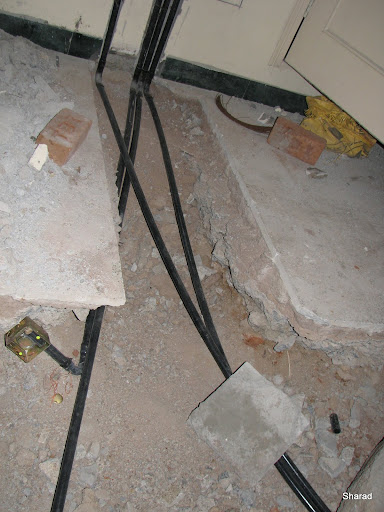

Picture 6 below
A closer look (also includes in/out sockets for the UPS powering the projector)
Picture 7 below
The switches at the hand level
Picture 8 below
Conduits below the floor going to the front speaker outlets on the carpet, and to the tactile transducers below the seat.
Thanks,
Sharad
