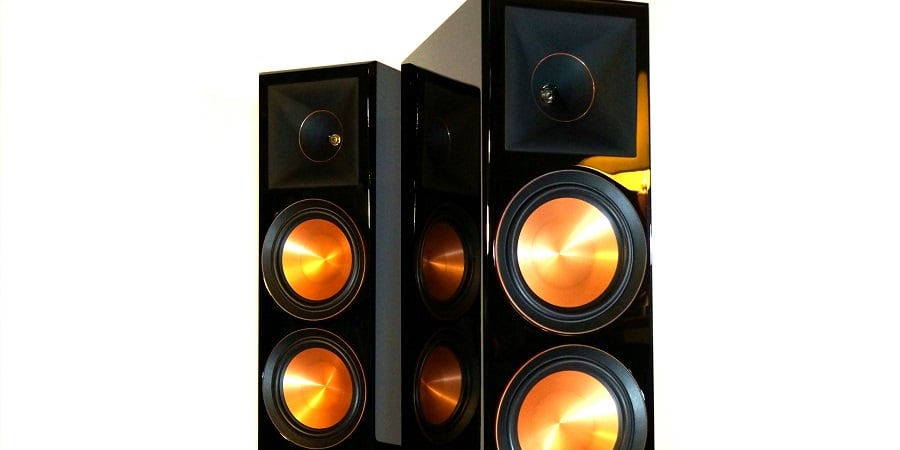

Yes most probably the klipsch home range is exaggerated in terms of sensitivity (going by your words as I haven't checked it) but so are most speakers.
I have read so many measures, both hobbyist and scientific, which have called out Klipsch.
The one I could find from the top of my head, am attaching here:
Having said that, I can tell you (to my ear; YMMV) the Klipsches were the most easiest to power among ALL the speakers I have auditioned so far.
I listened to them powered by a Denon 1400, and those bad boys (RP-5000F) were relentless, be it for music or movies. They weren't even as bright as people with the earlier R series had mentioned.
Real proper sensitivty can only come from some form of horn and/or bandpass enclosure that is large in size.
That's interesting, this correlation between sensitivity and size. Will read up on this. (So much to research in this hobby!)
As long as the speakers chosen are small/bookshelves and even if they have a small waveguide/horn, the sensitivity they possess will be limited to the higher frequencies and be much lower than a proper horn. Most people think in home audio that a 7-8" mid-woof is large but it isn't, whether a ported or sealed enclosure these will have limited sensitivity. Remember that a ported enclosure typically only aids sensitivy around tune and about a third to half octave above that.
This, as of right now, is way beyond my knowledge, as with most things. And, as always, will read up to try and get up to speed.
This, especially, I did not understand:
"Most people think in home audio that a 7-8" mid-woof is large but it isn't, whether a ported or sealed enclosure these will have limited sensitivity."

You need to understand that power is always in flux in a speaker system depending upon the content played.
With that out of the way, a sine wave has a crest factor of 3db, the loudest to lowest sound level. In most music you will fand a crest factor of at least 6db, live concerts have as much as 15db or even higher crest factor. Suppose you play a movie and the average level is 75db with about 20W, now there is a 9db peak, what do you need? 160W. Movies have a lot of dynamics which need peak power, it's why many HT fans are a huge fan of class D amps since they offer this peak power along with a more brighter sound that translates to detail in the movie. IF music is played with limited crest factor (compressed music) then you will need less peaks but the average power output from the amp will be higher, this will stress both the amp and speakers as they get closer to their limits, while for peaks both amps (class D) and speakers have far greater tolerance. For HT only I would recommend class D.
I'm sure they are correct, you'd need a much larger enclosure and horn to reach 98db than that speaker. The horn on that speaker isn't particularly big, and just 2 8" woofers.
No doubt since they have a small horn while most speakers have a dome tweeter. They also have dual 8" drivers compared to what I guess might be 5-6.5" woofers on other similar home audio speakers.
Sensitivity increases with size particularly as you go lower in frequency, addition of high sensitivity pro drivers help. Why do vented enclosure tend to be bigger? The larger cabinet volume helps with the reflex port to provide efficiency around tune. What this means is that a vented encloure will have a tuning frequency where it's efficiency is greatest and excursion minimum, below this if you operate it the driver acts as if it were in free air and excursion goes out of control, thus making it much easier to damage the driver. The thing to remember is that SPL comes from air displacement, the lower in frequency, the more air needs to be displaced. I hope this makes sense?
If you truly want high sensitivity then look to add dual 12-15-18-21" pro style drivers in a ported enclosure or the best option, a horn. Now not all of these choices can be used as high in frequency as a small 7-8" driver so there is that to consider. For the home segment of HT the Klipsch makes the right trade offs, though its specs may be incorrect.
What I meant by that was most people are used to a 5-8" mid-woof in home audio speakers, they think it's high sensitivity but it's not compared to the pro audio alternatives.

Yes the power part is directly related. I'd imagine on AVR power the Klipsch sound thin and lack bass.
He is correct, the small horn, though small, will offer much higher sensitivity than the woofer.
It did sound thin and light for sure!! The woofers came into life only after PAs
So, clearly adding power is the way to go.
