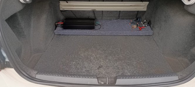

Not satisfied with the noise floor on the sound out put, so Found a better grounding place for amplifier power wires this is directly on the chassis.
Installed the amp rack and amplifier on the boot. Routed the wires as neat as possible to maintain lesser interferences. Secures the RCAs by tagging them, so it doesn't move or vibrate. this will ensure good contact.

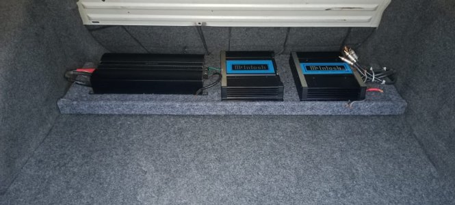

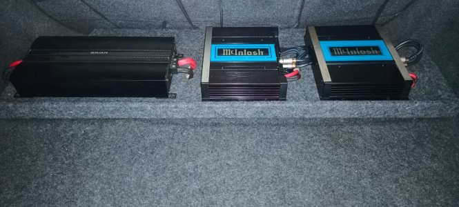

Wanted to try McIntosh Amps in this setup, So traded the existing Brian B4 amps for money few days ago to one of a known friend.
Just put the McIntosh amps to see if they can be inserted with out any hurdle. Found some adequate space, These are 2 x 2 channel amps, May need to drill additional holes on the rack for wires to accommodate another amp and re-route the cables. will keep posted.

Installed McIntosh AMPs Finally. Its wonderful to listen music in car now with the warmth of McIntosh.
So how has the music presentation changed after switching over to the Mcintosh.
Sir, I can hear more details and the presentation warm now. The harshness on certain high frequency notes gone now. can feel the depth better.
Did you have to retune or only play with the gains?
Only i have to match the gain, rest all remain same. Dayton RS180P-4 is rated 60W RMS with peak of 90W, but the amp is 40W RMS only. Bass notes are not as punchy as the previous amp which is rated 90W RMS.

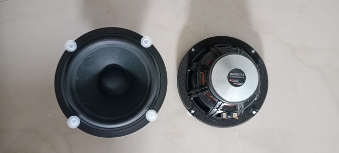

Decided to change the woofer to a less power consuming one, so that i can reduce the load on amp which is 40W RMS. Short listed the below. Please suggest me a 4 ohm driver which is rated 30W - 40W RMS.
1. Dayton Audio RS150P-4A 6" Reference Paper Woofer 4 Ohm
2. SB Acoustics SB16PFCR25-4 6" Paper Cone Woofer - 4 ohm
Any other options out there, please suggest me.

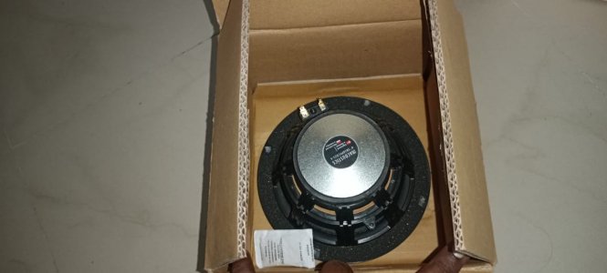

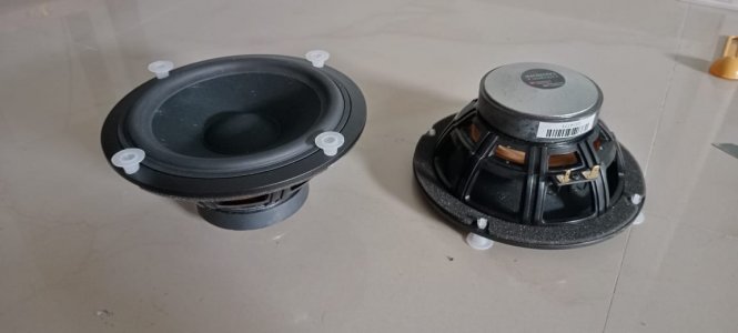

Got these for 5500 INR a pair from DIYAUDIOCART.COM, and it's delivered today. Dayton reference 6 inch woofer is 15000 INR, last year got it for 9.5k and didn’t like the price hike as its still sold in the same price on other countries.
Post after my purchase i noticed even this driver price is increased by 1200 INR. Can sense the tough situations for business people. And even more tougher economic situations for people like me.
6″ SB16PFCR25-4 / Paper Cone Woofer.

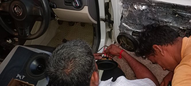

Update:

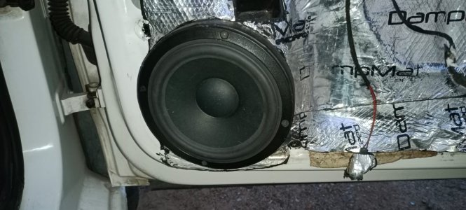

Yesterday had some time to install these drivers. its a simple and easy replacement as the spacers can accommodate this driver basket.
It’s an easy plug and play wiring. can notice the outgoing Daytons reference speaker lying on the driver seat.
4 Screw mounting on Spacer damped with rex to resist moisture.
Now the small amp can comfortably drive the speaker and the cone is kicking better, can hear the bass slam of McIntosh Amp.

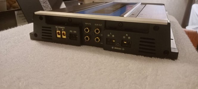

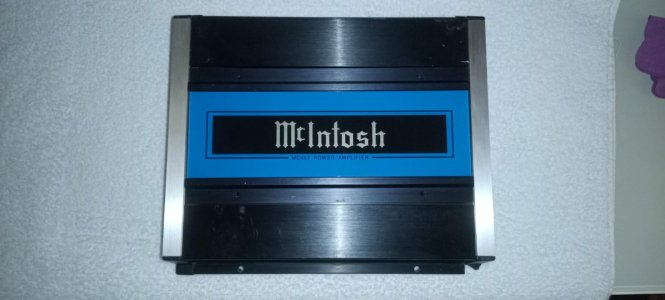

Got a chance to grab hold a 100W RMS x 2 Channel McIntosh MC427 Power amp for Kick bass. Will plan the install next week.

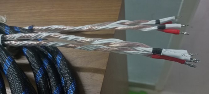

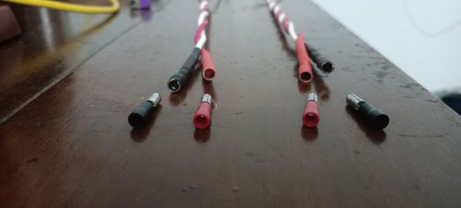

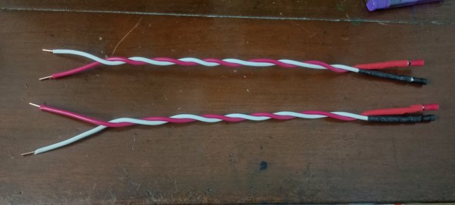

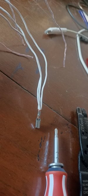

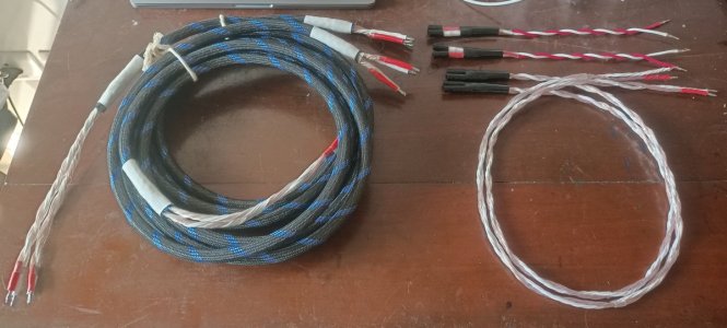

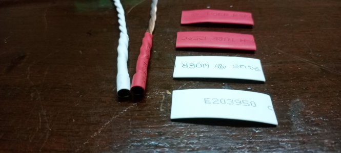

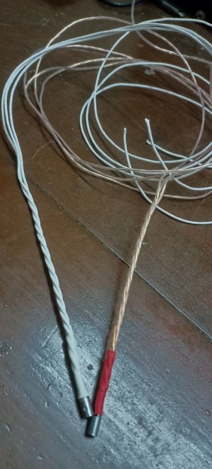

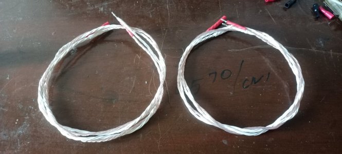

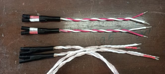

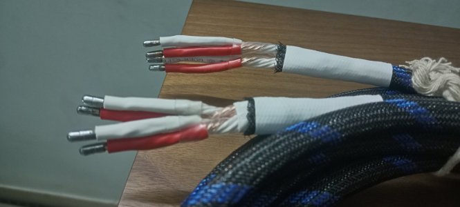

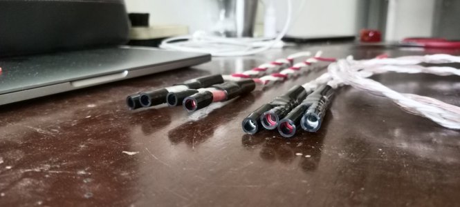

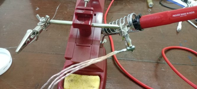

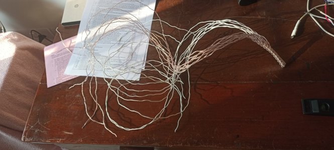

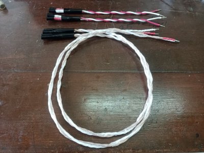

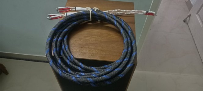

Ran out of solid core hookup wire, as I need 1 meter pairs for Midbass on the door.
So made hook up cables form the leftover OCC wire.
Striped 3 wires pair for - and + and straighten them.
Soldered to the female bullet plug.
Twisted the trio and put a heat shrink to hold them
Solder finished the speaker side end.
Applied transparent heat shrinks to the full length to cover and hold the cable.
Added this nylon sleeve to keep it noise free from vibration and can insulate the bullet pin joints.
