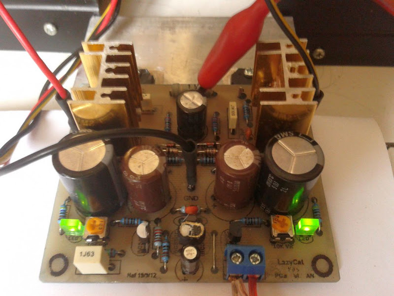

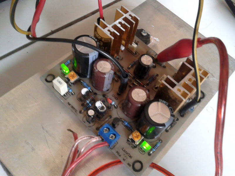

Hi omishra. Thanks. An Indonesian friend of mine has build this board and you can see the pics of the complete boards below and see what he has to say about the sound here:- Naf's Reaction to SSA sound

BTW your Indonesian friends board is looking good.

Yeah he built it as soon as I uploaded it in diyAudio. Fast guy!
Here is a shot of his second channel with better capacitors.
