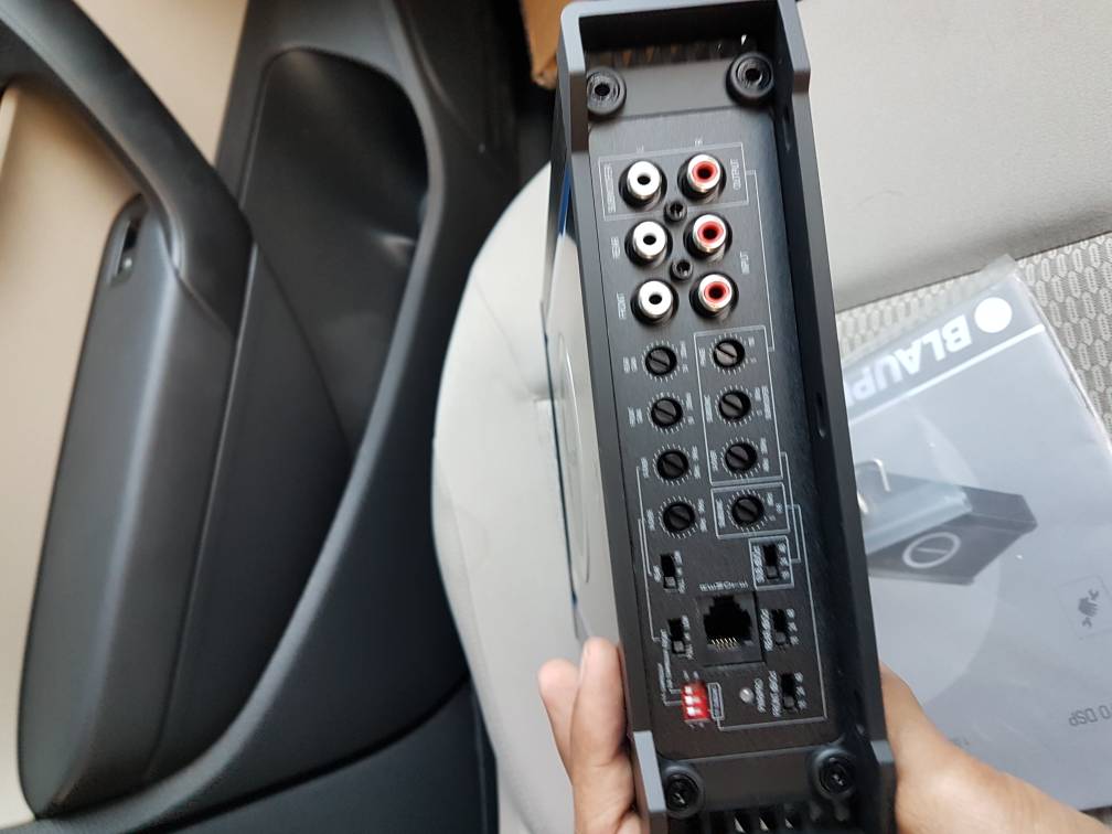

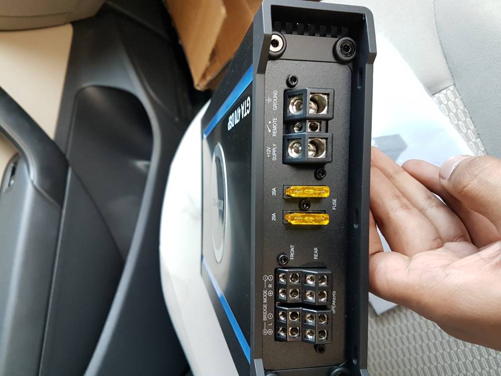

So finally upgraded my sound system a month back. So the current setup is as follows
-Head unit : stock hu
-Amplifier : blaupunkt gta 470 dsp for speakers + v12 4ch for sub (plan to upgrade to mono)
-Speakers : mtx thunder tx2 component speakers in front stock in rear
-Sub: old Chinese sub in ported box
-Damping : stp in front two doors

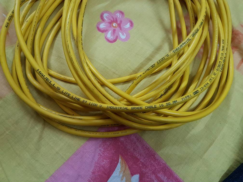

-Wiring: using havells 16mmsq (read 6awg) separates wiring for both amps.
There is a lot of improvement in the sound stage and sq. Definitely I look forward to further upgrades step by step and slowly.
Special thanks to NIRDESH_KUMAR sir for helping me out in the whole process. He even took out time to be there for the installation and helped me in tuning.
Don't have any pics of the install but here are a few pics of the products used.
Sent from my SM-G935F using Tapatalk

Looks good..could you share the settings of your amp? crossover frequencies and gain for Front, back speakers and sub ?
