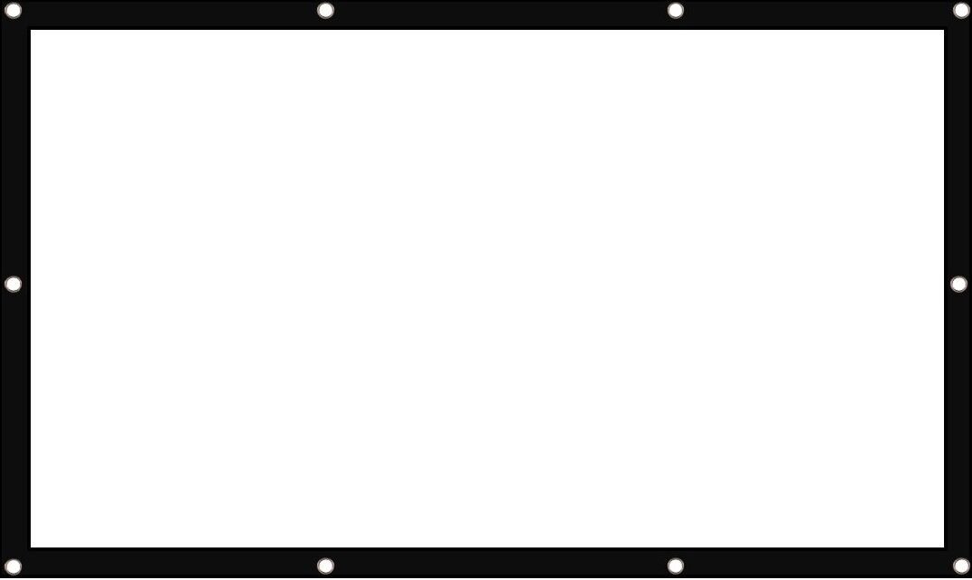

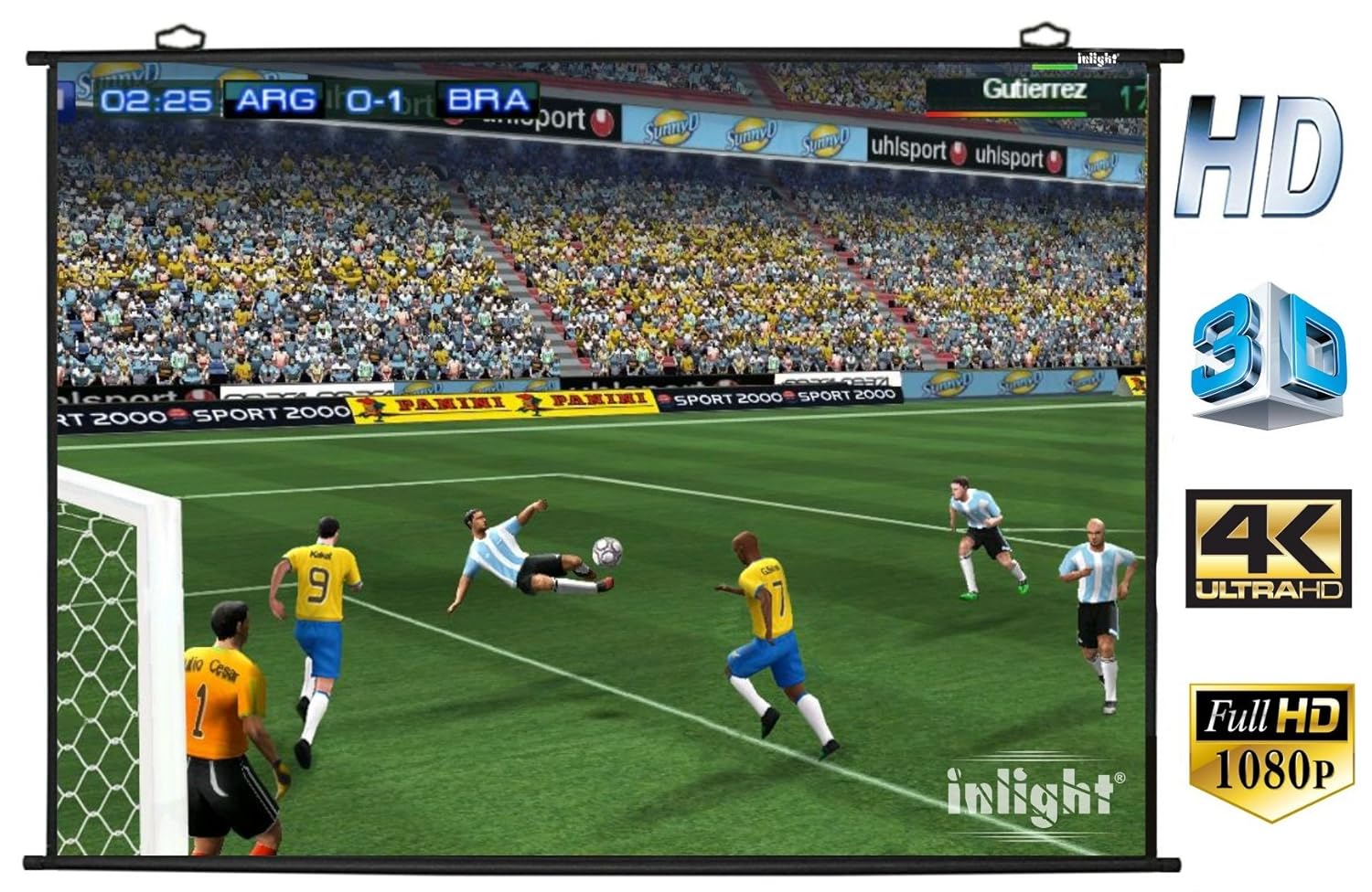

Also could you recommend a good 16:9, screen too. Was considering the Inlight 7 by 4, 92 inch one
Most of the screen aval on amazon.in are manual pull down type, with & without insta lock.. If you have regular wall and want to pin the projector screen to wall, then map type might work cheaper.. Which one do you prefer?..
something like this -
(or)
something like this..
Have just emailed the company & will talk to them tomorrow for the best price & warranty.
Thinking of going with the 2nd type (pull down with instalock)
