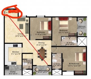

Hi All,
My new flat has wifi router provision at red colour marked place. Please suggest WIFi router/extender/mesh to cover wifi complete house.
Hi All,
WiFi Mesh system is your best bet.
Place one of these in the red-colour-marked area, and another in the dining area. This should easily cover the whole area. The second device is connected wirelessly, need not worry about pulling a LAN cable. You only will need a power source at the second device's location.
If possible, maintain a line of sight with the main 1st device as much as you can when you place the second device.
Thank you. For each room lan cable already pulled can we use that ?
You can connect the second device (or as many from the same family of devices) to LAN in each room. But, it wouldn't be required for the square footage you've mentioned. Get these two first, if need be add more later.
Since you already have Lan cable available in each room, I wouldn't bother for a mesh router. I would go for a AX router to be future proof (for couple of years). You need to add just one more router in one of the BR on the opposite side to get a full coverage across the house.
Before investing on a mesh router, try to use one of the existing routers that you might have or borrow one and test.
Even if you have Giga broadband service, using a cable connection is always better than tri band back haul used in mesh routers.
Check out Asus, Netgear or TPLink routers. I use Netgear AX20 router and pretty happy about it. But using a router UPS is must if you don't have online home UPS.

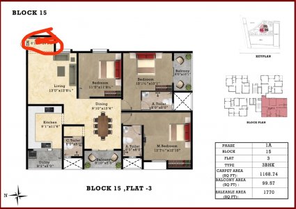

Hi All,
