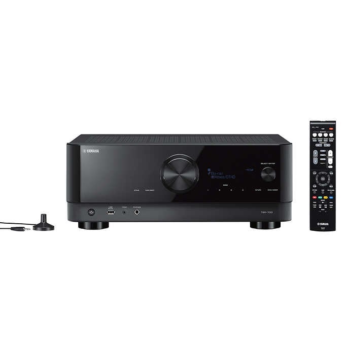

I have the PIoneer 1020-K receiver which is 7.1 I think and it has served me well for 10 years and still going strong. With Dolby Atmos receivers becoming affordable and unlimited internet thanks to Excitel - I thought it was time for me to upgrade.
I found this Yamaha TSR 700 7.1 receiver for 440 dollars in US. Could not find India price but I am assuming it will be at least two times. My friend is willing to get from US...so say with Taxes it will be around 35K - is it ok to get this particular or look for anything else?
I am not a audiophile and I just want to add Atmos to my existing 5.1 Andrew Jones Pioneer setup and this is the cheapest one I found and reviews seem to be fine except for few issues. But no matter what brand of receiver reviews I read - people are always complaining.
Assuming something goes wrong with this in India - Will I be able to get this repaired? I am assuming if it has an issue - plus the repair cost - it will still be worthwhile to ask someone to get it from US as my existing Pioneer is also from USA and so are my 5.1 speaker+ sub setup and they all are working great for the past ten years - i use a step down transformer for my receiver and my sub woofer.
Also let me know if there any other good options below 600 USD mark as I dont want him to undergo any customs hassles. I have another 45 days to order as he is visiting mid may.
Thanks in advance for all your help!!
I have a desktop with RX 570 - I hope the HDMI to these modern day receivers will work to get Atmos sound? I mostly plan to download movies, since as I mentioned, I have unlimited internet I only watch one movie a week or a fortnight and typical Atmos downloads are around 15 GB per movie. I do have Netflix/Amazon/Hotstar...etc and not sure if they will output Atmos signal if played on a computer...I will google on this myself but my preference is to download the movie watch as these streaming services are glitchy sometimes plus clarity is not that good compared to playing a file off a desktop

Before you pick this up, why not contact Yamaha India over phone and check if they will service / repair this model if any issue in the near future? I dont think this model would be covered here and getting spares would be challenging. Why not explore models that are available in india and then decide if local purchase or US purchase makes sense?
Yamaha V6A which is the same one as this as per Youtube reviewers...listed at 62K on a site and sold out and on Amazon Atmos receivers are all 80K and above.
Given V6A is sold in India - I guess its safe to assume it can be serviced here as well. I will go ahead and ask my friend to buy the Yamaha.
