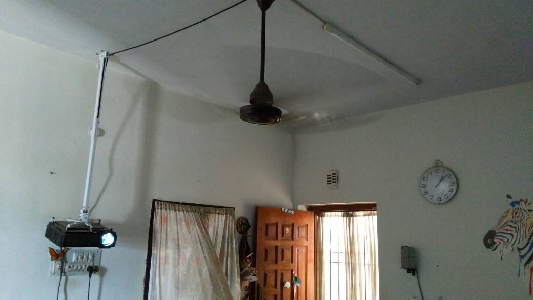

Can you please share, what projector mount is that?

Any trouble mounting the projector?
Any tips?
Thanks,
Bhushan.
Re: Projector mount
Any tips? Thanks, Bhushan.
Nope.. no trouble.. The Projector didn't come with ceiling - mounting screws.. You may have to find compatible screw..
Don't use the Key stone (tilt) on the PJ.. It robs the sharpness of the picture towards corners..

Hi.
Can you please share the projector-to-mount screw arrangement?
I don't see a clear provision (or I am missing it somehow) in the P531.
Yes, my plan is to *not* use the Keystone. It indeed messes up the sharpness and focus.
I got a cineview screen which is 8x6 @ 3500 INR (from ebay).
I got the 8x6, since 9 feet mounting did not give me enough space on the sides (for speaker setup).
Also, 8x6 gives good tolerance to play with the height ( will help minimize the keystone inputs)

Hi.
You can find the mounting keyhole on the bottom side of the PJ, on all 4 corners.. They are covered with rubber feet.. Once you pull the rubber feet, you can see the mounting hole..
I used the mounting screws that came with Excelvan CL720 Projector..
Yes.. In my case, the top left corner loses sharpness due to the way i have mounted the screen and using keystone correction..
Ah. Okay. Understood.
Inspite of 4 feet of projector mount (drop height) from ceiling - you had to keystone the height?
Yes for two reasons.. The projected image starts 1 foot from the floor
- If the PJ is parallel to floor surface, the image starts at higher height .. Above 2 feet from the floor, which increase the overall height of the projected image, and there by strain on the neck..
- So had to tilt the PJ (to get image from 1 foot of the floor) and forcefully use the keystone adjustment to get a perfect rectangle..

Re: Projector mount
Here is the image..
That helps a lot! :)
This was the tilt i was saying in earlier post..
Try keeping a "recline" angle in your seating (with pillows or other stuff)-
that will help pushing the screen 2 feet above the floor level >> No tilt >> No keystone = Best possible picture :D
Just a suggestion.

Re: Projector mount
Just a suggestion.
Thanks.. Pushing the screen 2 feet above floor, at 10 feet viewing distance will put strain for prolonged use.. if it is only for movie watching for couple of hrs, i wouldn't mind..
