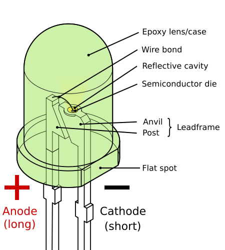

Question: Though I haven't reached it yet, I can see an LED lamp. How do I determine the correct terminals on the LED? On the board, one side of the circle is flattened so I am assuming it means something? I know that if I put it the wrong way, it should be equivalent to an open circuit, but that's discovering the correct leads the crude way.
Yes Sachin bought 150V rating caps in place of 63V, so footprint increased. Still no issues.
Observe the circle area of LED on PCB. It has flat line cut at lower end above letters "Red 5mm". There you have to match base of LED which is also same flat edge.
